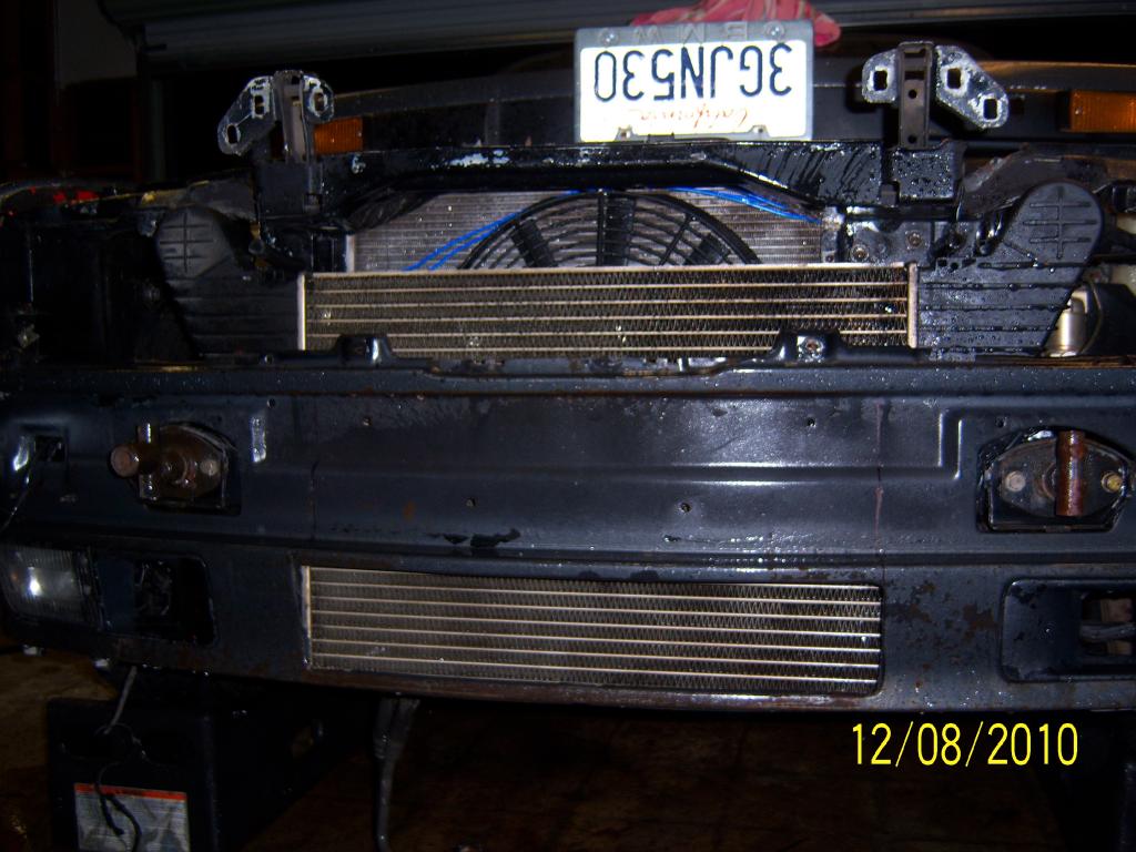

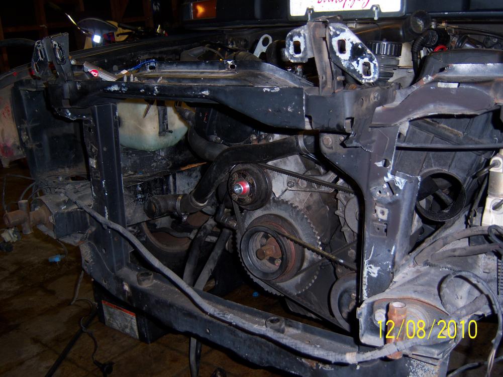

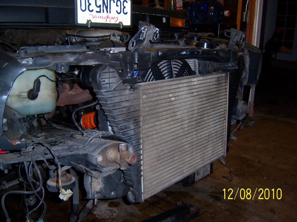

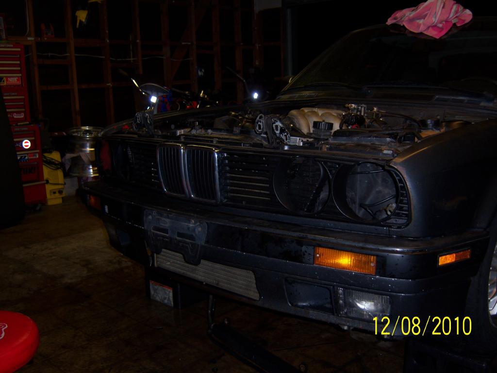

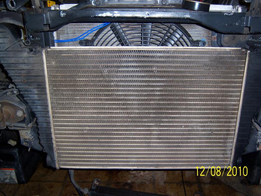

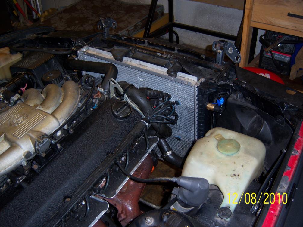

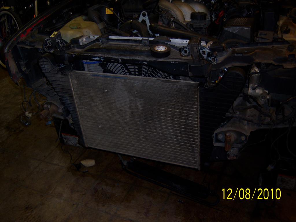

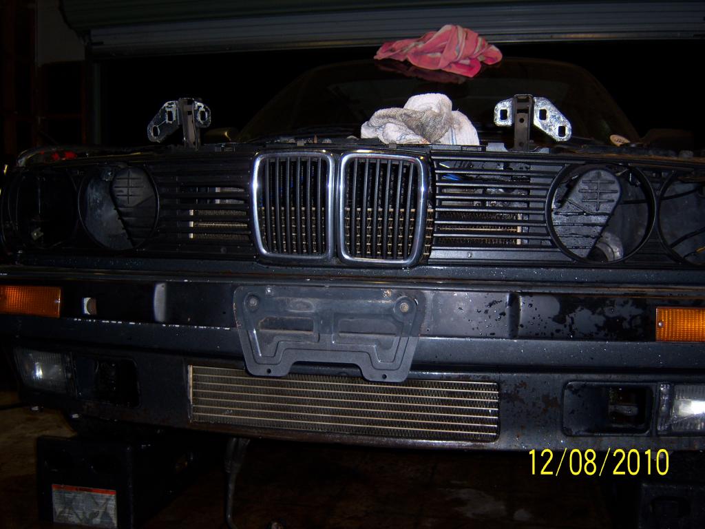

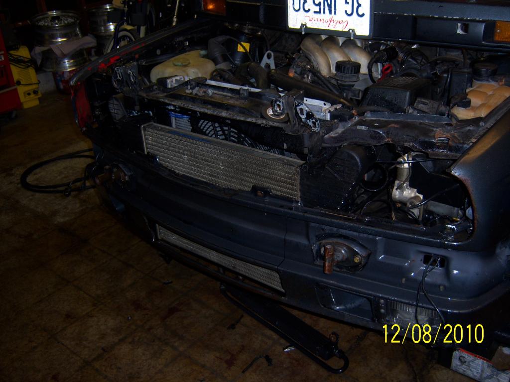

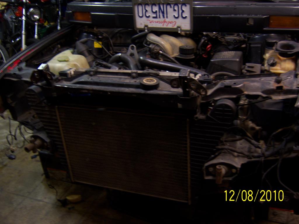

                    Ok well I got fed up and tired of procrastinating...
                    So I already had the front end torn apart. So I pulled out the
                    heavy tool and cut up my shit and mounted that fucker..!
                    I'm soo fucking happy with how it turned out..
                    took afew pic's and pulled this off in about 3hrs.

                      So looks like the last thing I have to do is relocate and mount the oil cooler. Then cut the light buckets to remove the high beams..
                      I was thinking about the open holes so I'm going to cut up some lights and make faux-high beam light to fit in the open spaces...

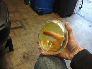

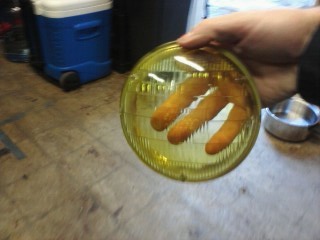

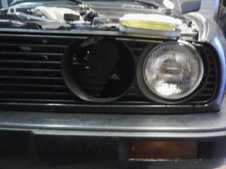

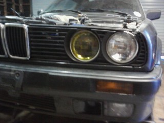

                          Mean wile back in the bat cave..
                          The Faux-high beams I've been working on
                          Lost one in the first attempt..
                          But I figured it out! :mrgreen:
                          So my plan it to back it with polished aluminum to give that deep light
                          look and drill a small hole at the bottom and inset a blinker bulb..
                          to have them act as running light and a blinker..
                          Then get the euro bumper trim from blunt and delete my bumper blinkers..
                          is that too -> :loco:
