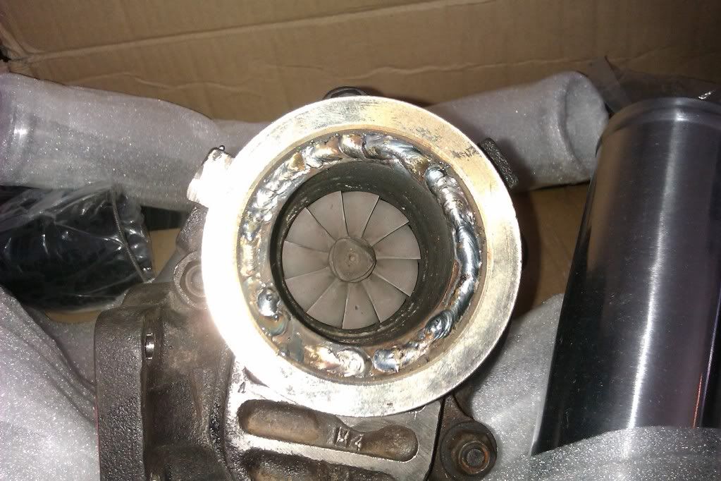

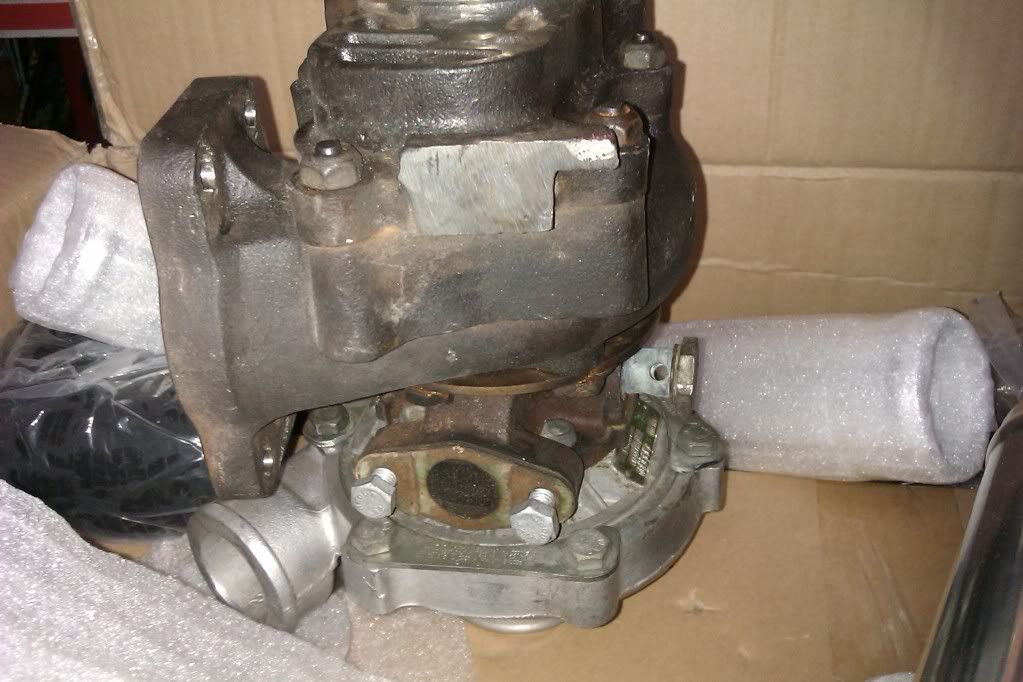

                  Now they sell a garrett style flange that goes straight to v-band but that cost money. I have a stack of v-bands since I buy them by the box so this was a cheap alternative to keep me occupied. First thing is to cut off the arm that connects to the wastegate diaphram. Then drill in a slight recess on the shaft portion that is still in the housing. Push the flapper closed and weld the recessed area this will allow you to change the flange if you change your mind in the future. Then wire brush the original DP area and weld on a 2.5" v-band. If you read the decriptions some of them are mild steel. This would be prefered to stainless since it has a lower thermal expansion rate. Grind smoth and enjoy external waste gated, v-banded turbo for under $20.
                  www.gecoils.com
                  • einstein57
                    • Jun 2007
                    • 10780
                    This is where the flapper shaft was
                    The inside before I did the final pass and grinding.
                    www.gecoils.com
