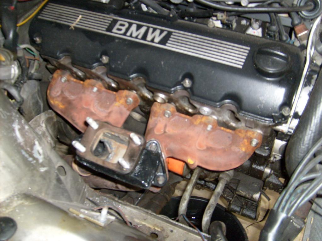

    i turbo charged a stock m20b25 engine, i have it set at 5 pounds of boost, i only have 19lb injectors, here is my issue
    when i shift from 1 gear to another the whole thing cuts out for a short second? any ideas? im thinking i need more fuel but i just if there where anyideas???
    and here are some pics of the set up

    yeah probably. No wideband?
    What's that second hose going into the elbow before the throttle?
      Also would like to know. If its the one from valvecover ur running boost in the oilpan, and thats not a good idea.

        that is the stick set up with a aftermarket elbow, , runs from the elbow to the other 2 lines going into the throttle body, i have the valve cover line going to a oil catch can do relieve pressure, is that right...???
        and i was going to get 30lb injectors installed wih a fuel pressure regulator or a rising fuel rate regulater
