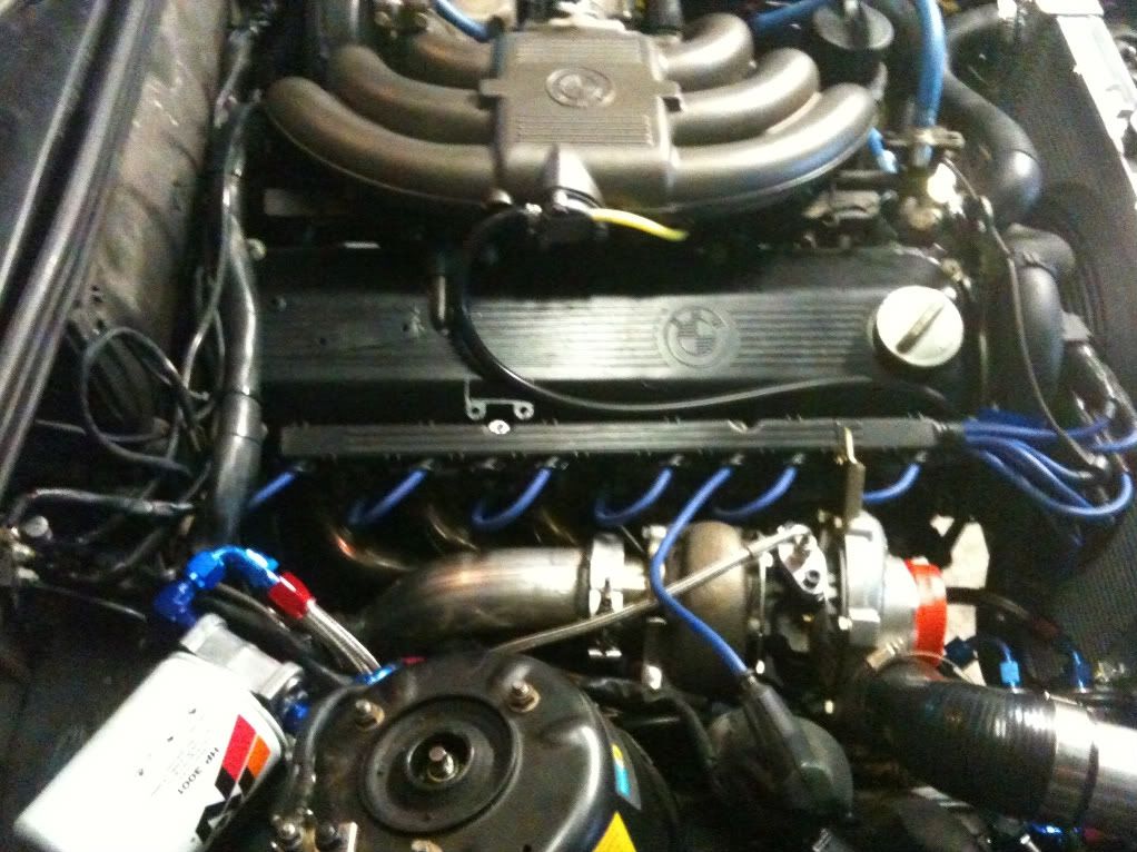

    I have a m20 with a t3t4 turbo running 30lb injectors with 40 psi for fuel pressure the idle on my car sucks when i first start it it gets a little better once its warms up any one have any good tunes?
    Do you have any pictures of your setup?
    When you first start the car it enters the warm up phase and ignores all of the adjustments that you made to the AFM wheel (if you made any). This could be one of your issues.
    After the car is warmed up, how does it idle?
      yah i got a ton from when i first swapped the motor. ill post em up once i get the chance. once it warms up its alot better. what do you mean by afm wheel
              Looks like a nice setup.
