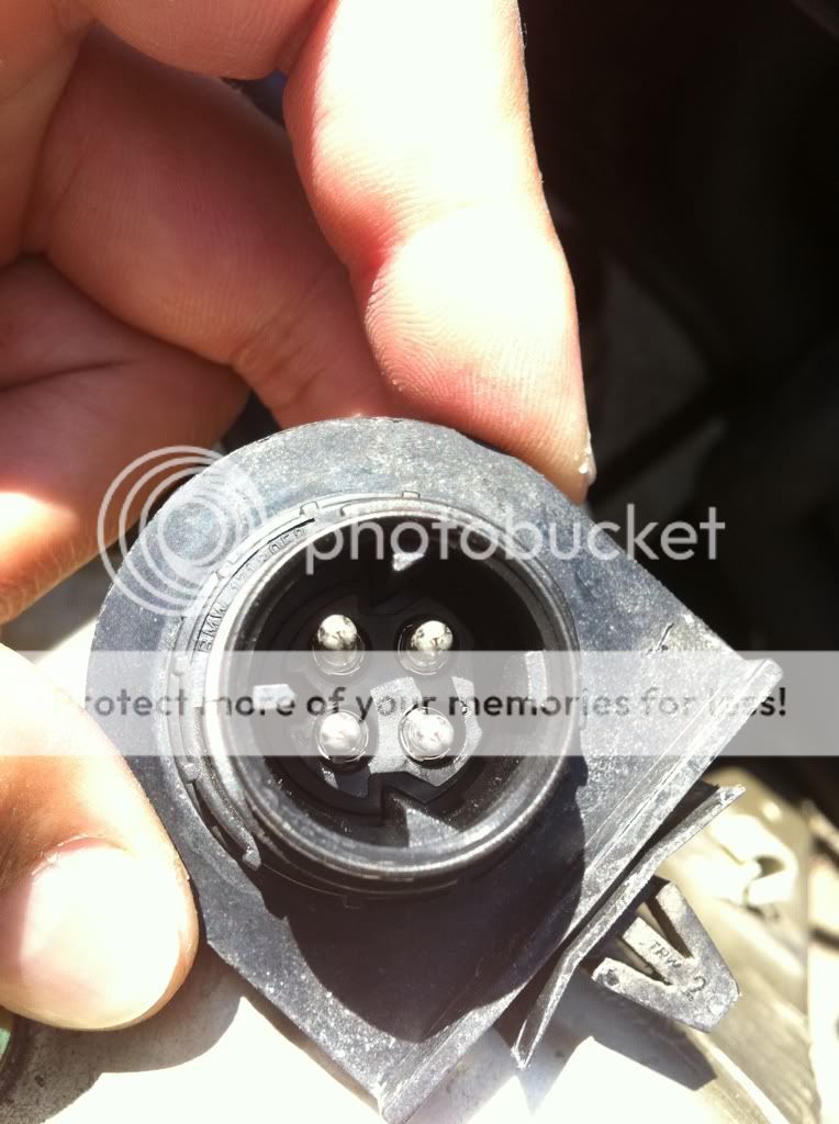

              Here's what I did. By no means is this the best way...but it works for me.
              I spy boost gauge ;) I have the same one.
              Do you have a 7 wire lc-1 or a 6 wire? I imagine you have a 6 wire. Those seem to be the most common.
              Basically the stock o2 sensor is sending a narrowband signal to your ecu. Your new LC-1 can do the same thing. It has an analog out (yellow wire on the lc-1) which can take place of what the stock o2 did and send the ecu a narrowband signal.
              What I did: deleted stock o2. Welded on new bung for the new sensor. Stripped back the harness for the stock o2 (sensor side, NOT ecu side) tapped into the wire for the narrowband signal and the ground and the power. The ground and power both gave me issues so I ended up grounding it out on one of the shock tower bolts and the +12v I got from the little box next to the fuse box. One of those is a constant, one is switched. You're going to want the switched one.
              Stock o2 connectorfdfdfdfdfdfd LC-1 wires (only need the bold one)
              Yellow --------------------------- White
              Black ---------------------------- Yellow
              Brown --------------------------- Blue
              Green/blue ---------------------- Red
              Pictures of what I did (I thought I was going to be using all of the 4 wires, that's why I did it this way)
              Take out o2
              Cut
              Wire in new wire. (I made this picture just for reference) Only do the narrowband signal...don't do power/grounds. Attach the yellow wire coming off of the lc-1 to the black wire coming from the harness
              The harness will look like this. There are 4 wires.
              The confusing part is is that the color of the wire changes when it goes through the harness....don't worry about that though. Forget I even said it :)
              Ground out your grounds, give it the switched +12v, wire up gauge/calibration button, calibrate, and tune!
              Hope that helps! Let us know if you have anymore questions. I was in the same boat as you when I was trying to wire mine up.

                    okay so, i get that i have to wire the BLACK wire from stock O2 harness to the YELLOW wire on the LC1 but now what do i do with the Other color wires from the LC1 like, BLUE, BROWN, and the 2 WHITE wires from the stock connector>?? ,i read the black and red from the LC1 are for the button and light power n ground right?
                    but then i was reading this www.e30tech.com/forum/showthread.php?t=50206 and at the bottom he explains what he did and its different from what you told me JAY , he says the Brown wire from the LC goes to the black wire on the o2 ...SOOO CONFUSED can someone just let me know what they did lol but JAY if it works for you i guess ill just wire it how you did it.
                      There's different opinions out there on which sends the narrowband signal, so I called innovate. I asked them and they told me it is the yellow wire (analog 1) that sends the narrowband signal. So for me, I used the yellow wire. I have no issues with it. Do your homework though...I have no doubt some will argue with me.
                      As far as the other wires go...
                      Red 12V supply
                      Blue Heater Ground
                      White System Ground
                      Yellow Analog out 1
                      Brown Analog out 2
                      Green Analog Ground
                      Black Calibration wire
                        ohhh no doubt yeah ive been looking at ton of pages trying to get an idea , thank you tho ill be sure to let you know how it goes....trial and error =) just one question, the brown wire in the LC1 is not really used right?
                          Correct. Just cap the brown wire off
                            LC-1 Wires------------------------------->STOCK o2 PLUG
                            YELLOW-------------------------------------------------------------->BLACK
                            RED LED & BLACK Button wire + RED LC1 wire----------------------------------> 12v WHITE
                            BLACK LED wire + BLACK Button wire + BLACK LC1 wire-----------> GROUND WHITE
                            BLUE & WHITE--------------------------------------------------------> Grey
                            BROWN is JUST USELESS????
                              Wait, why are you connecting so many wires to the o2 harness...?
