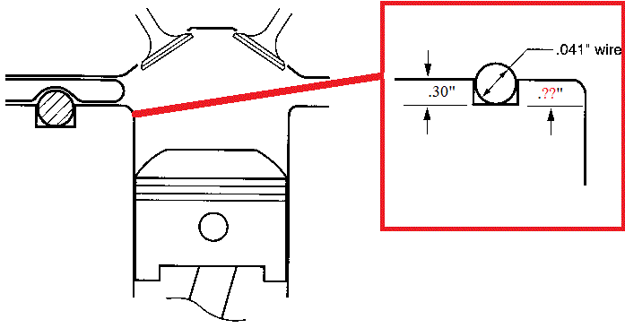

So I am gonna o-ring my boosted m20b25 block. Determined that I am gonna go .30" deep on the groove with .41" copper wire "8" pattern but can't seen to figure out how far out from the cylinder bore. Anyone already done this and can tell me how far out? Have not taken it apart or else I would just measure. Thanks in advance guys!
