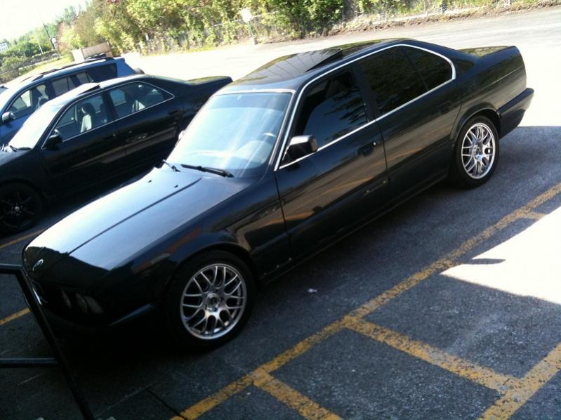

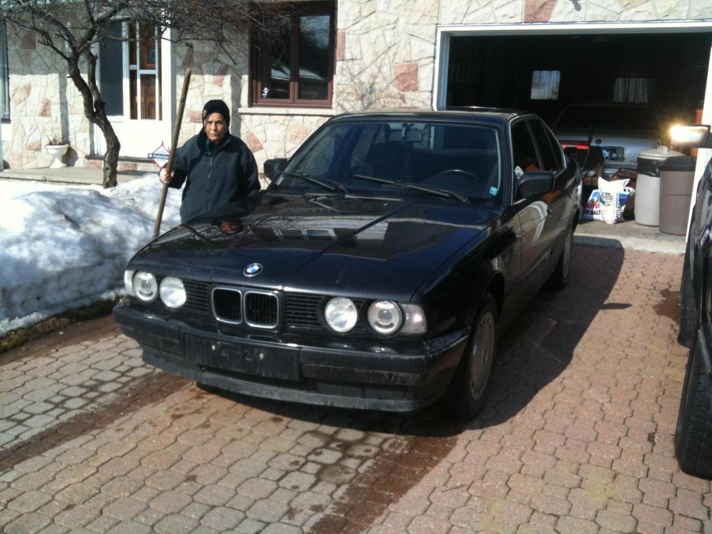

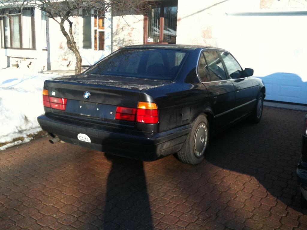

Hey i have a 90' 520i that i purchased for 800 bucks, at first i bought it for a dd but fell in love with it now im aiming for a good looking street car.
I dont have any pics of the install but i put on bilsteins tourings woth h&r sports, tinted the windows and put a cheap set of 17's on

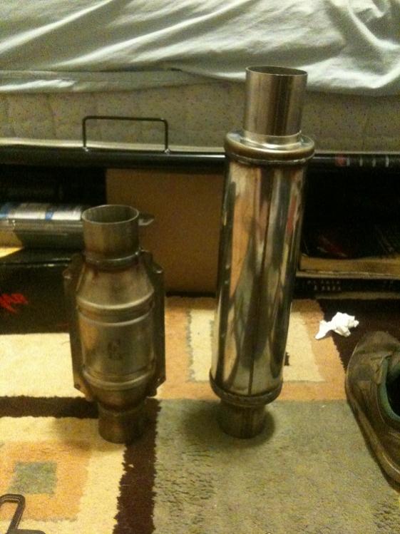

This winter i decieded to park the car in my garage and start on the turbo build... The first dumb thing i did was purchased a turbo kit
From this kit i used the waste gate, and all the lines and hoses, intercooler piping, air filter... not much... so it was a huge mistake...
i upgraded the manifold to a TCD M50 Turbo mani. the turbo i went with a t4 center housing GSP turbo, i changed the intercooler, and BOV

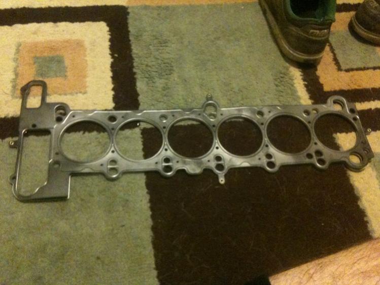

The first thing i did was changed the H.G. with the MLS
sorry i got to excited and slapped the head back on before i could take pictures

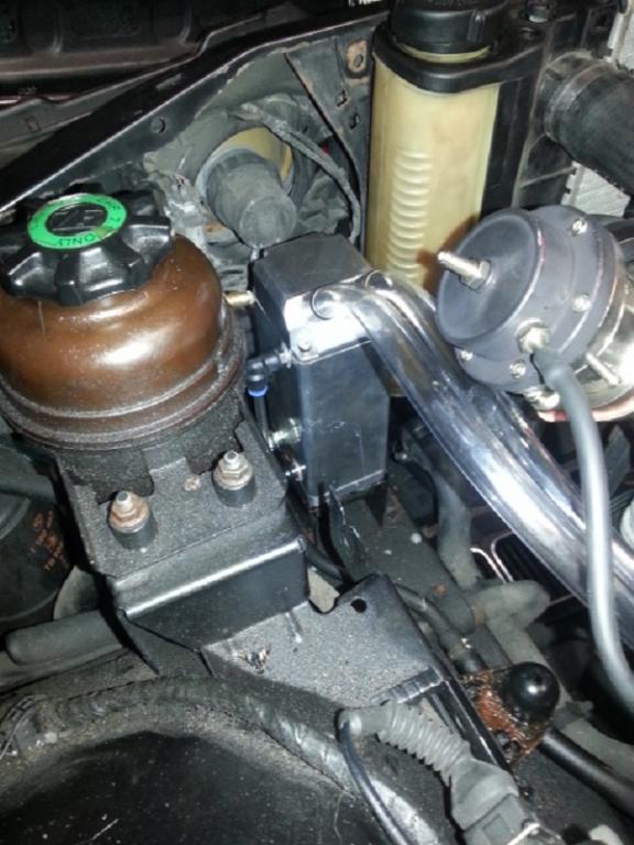

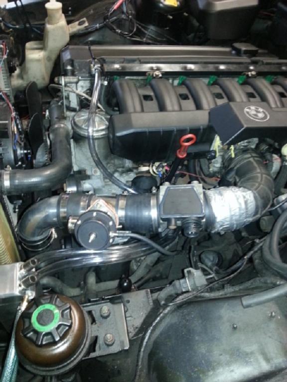

i continued with installing the rest of the paskage and took picks of it together... but with no exhaust
and i have a video of the good starting of the setup, i didnt have the icv hooked into the mani soooo it didnt run, as well i was a tooth off on the timing chain
