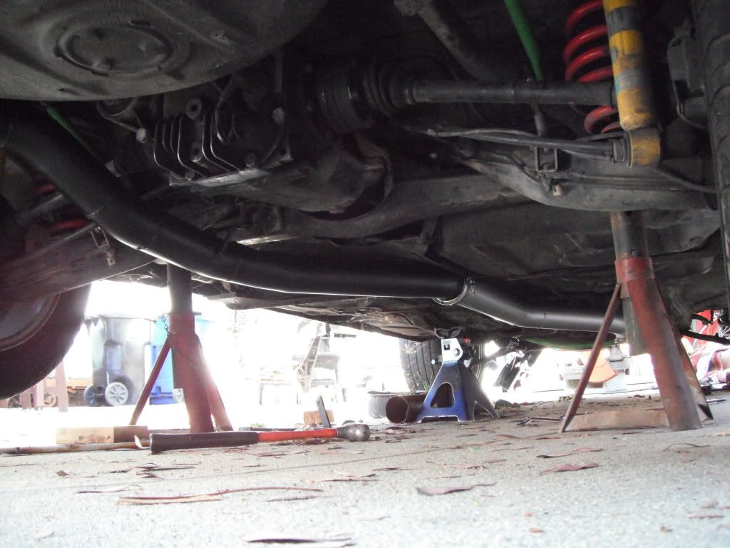

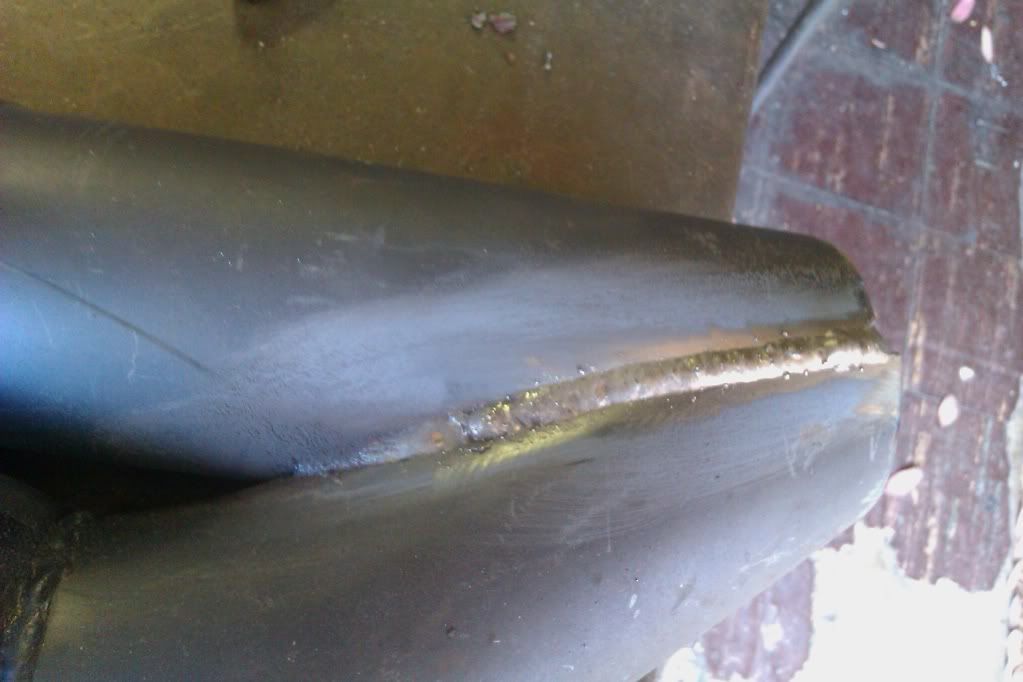

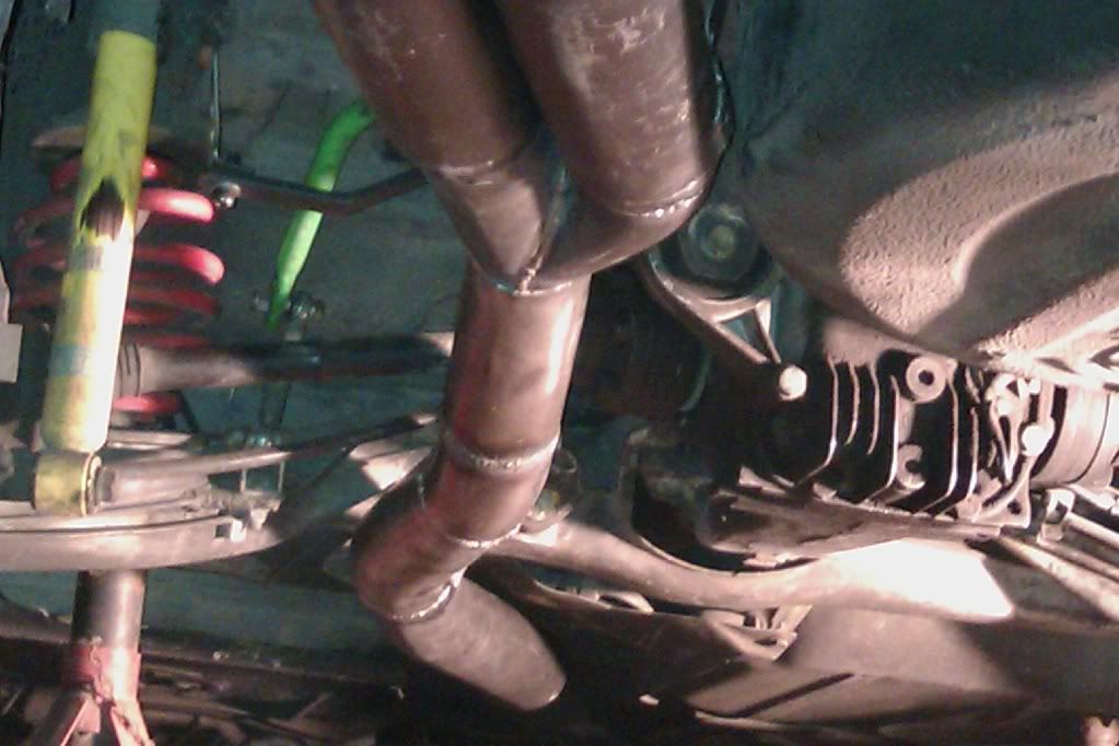

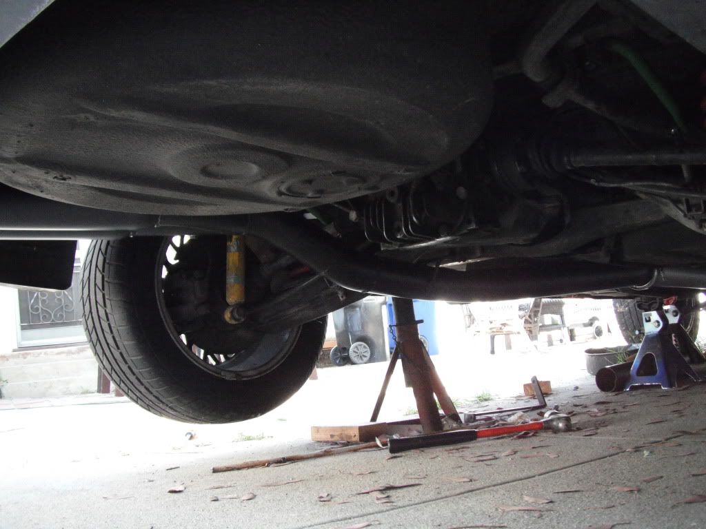

    I got all of my exhaust stuff from summit (minus the mandrel bends which I sourced on eBay) I built this on jackstands with the mig welder on the other side of building.
    Here's the downpipe
    2.5" --- 3" adapter (bought the 2.5" downpipe and didn't feel like building a new one at the time)
    Used lots of sharpie marks, tacked with the mig, test fit, tacked some more.

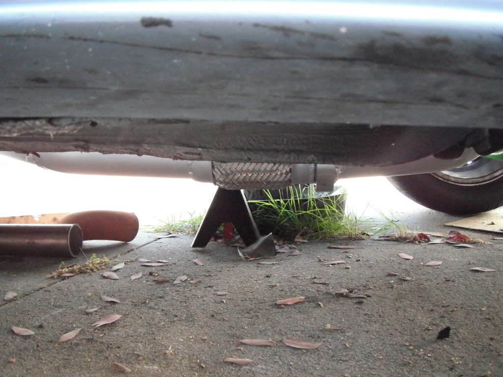

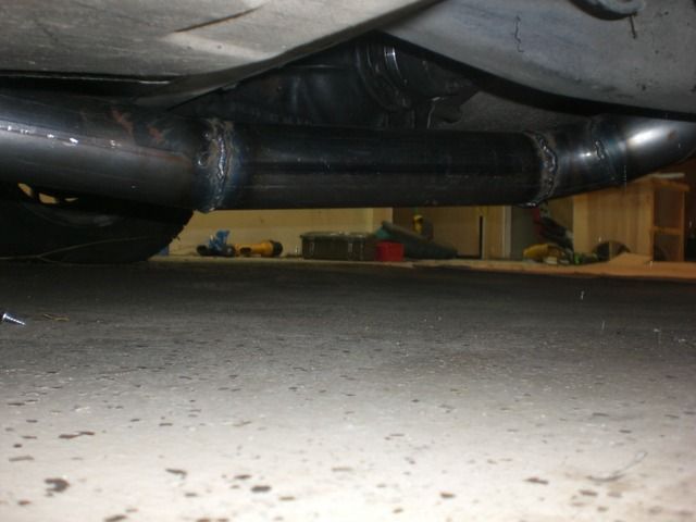

    I used a flex pipe (you NEED one of these) and a glass pack from summit
    Here it is, all tacked with the Summit Turbo Muffler at the rear.
    Test fitting
    Painted

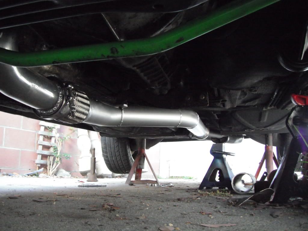

    Here's one of the hangars I made. It worked, but not too well. I will be doing it differently next time around

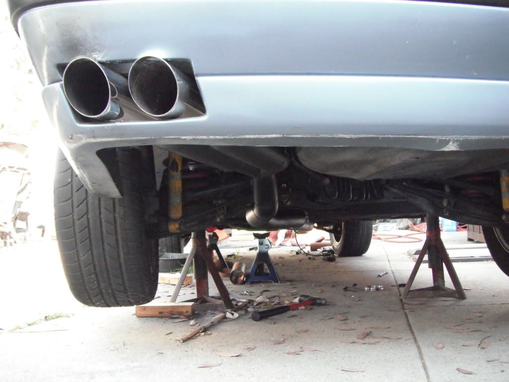

    Don't forget about the bung for the wideband!!

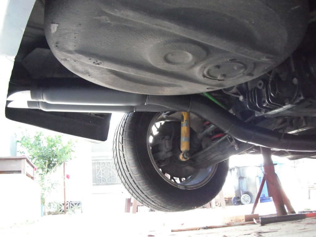

    All done, minus the tips. You can kind of see how low the 3" exhaust will be.

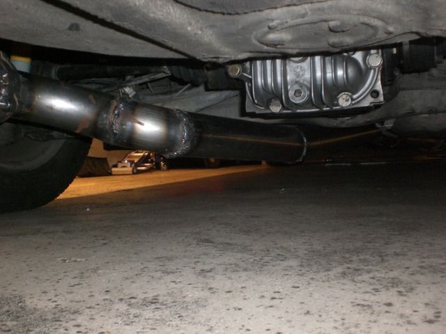

      here's a few pics of the exhaust mounted up. The back isnt hanging correctly in relation to the rear valance. I still have to finish up mounting the valance, then i will change the hangers and what not. Anyways, i think it is tucked up there pretty nice, and for my first welding job i think it came out halfway decent
      Sorry for the large and sideways pics. Photobucket is being lame for some reason

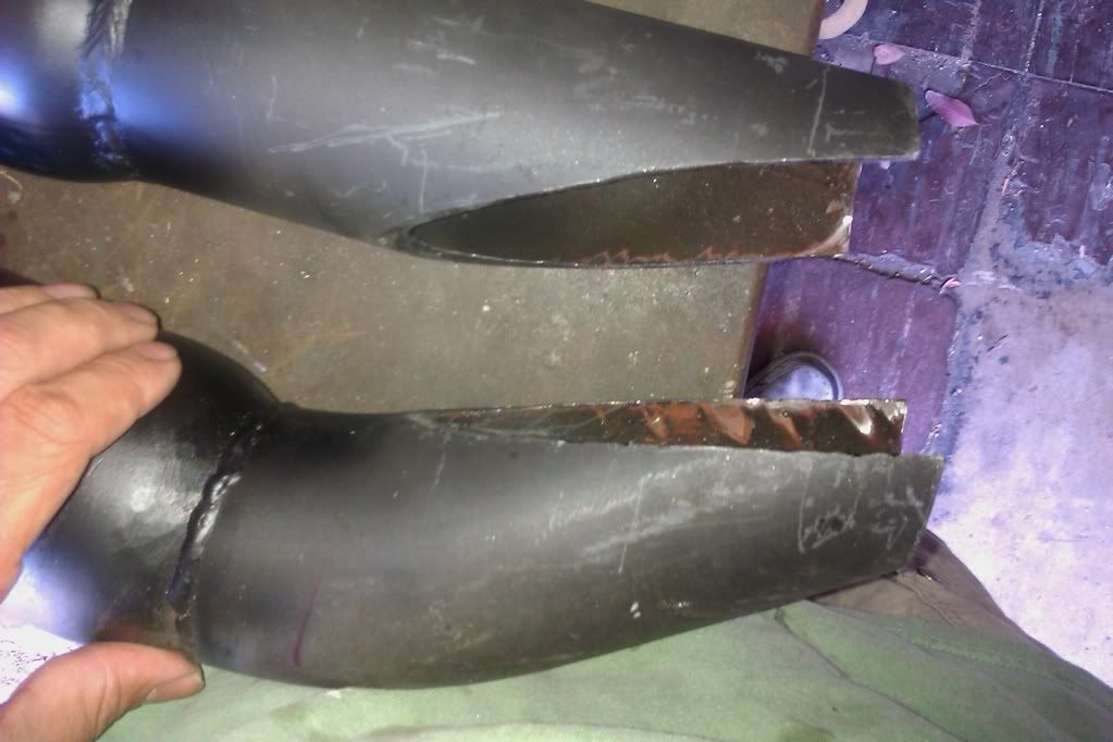

                one i did for a customer

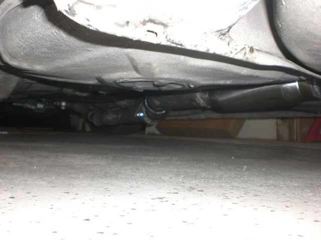

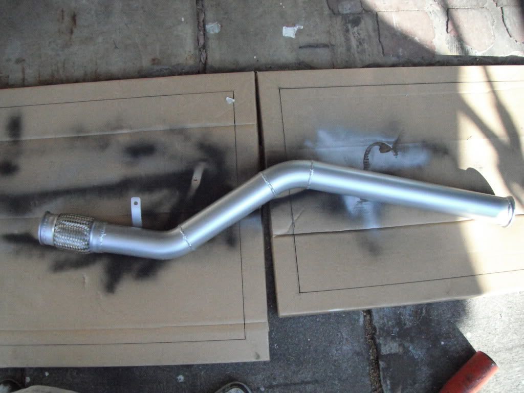

                            down pipe was made by me and i used a buddy club exhaust off of a s14 240sx and just modified it to fit the e30 and added a flex pipe. exhaust is 3" with a 4" blast pipe

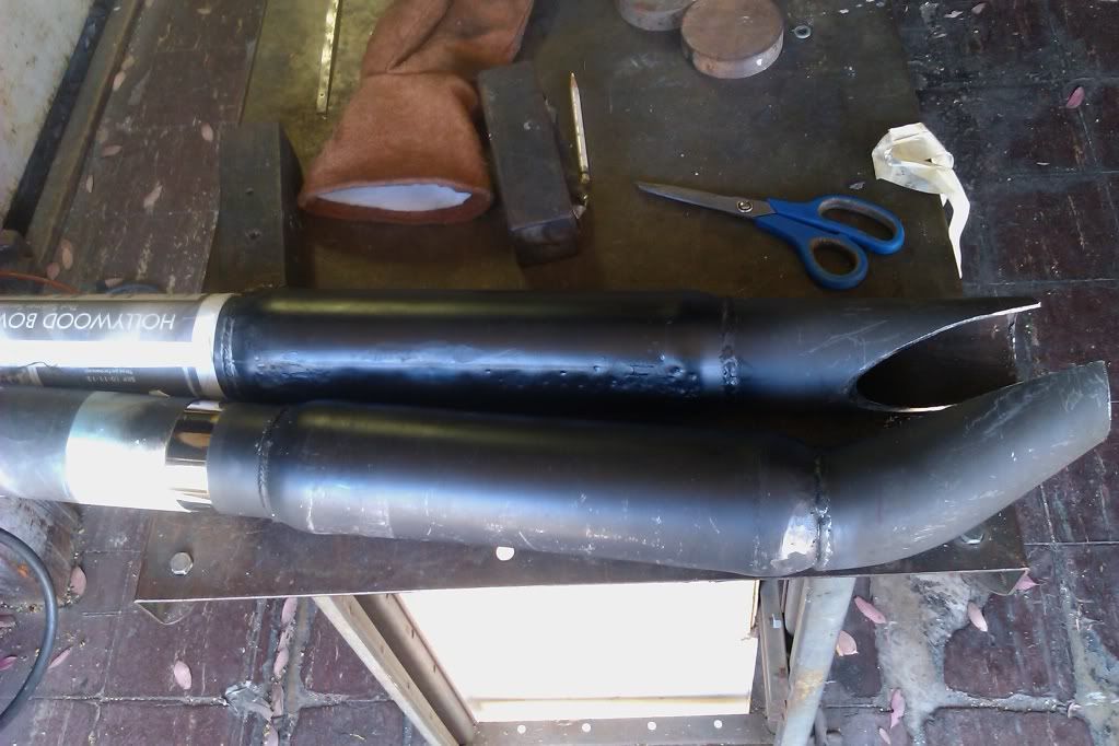

                              Finished the exhaust. Full 3" into a Vibrant muffler 3" inlet-dual 3.5" outlet
