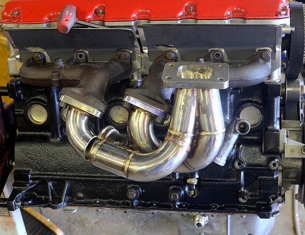

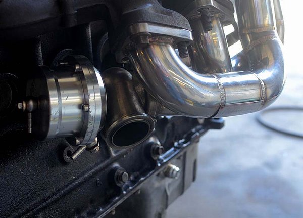

    OBX headers did not fit so we cut them and will weld an insert so we have a perfect fit and seal.

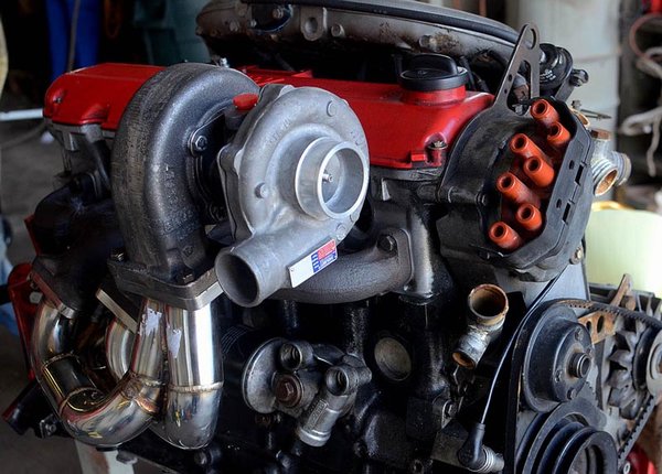

    New Holset H1c, it looks like a nice little turbo which I hope with give me excellent power and yet keep it a nice daily driver.
    The oil return line connection is welded into the pan.

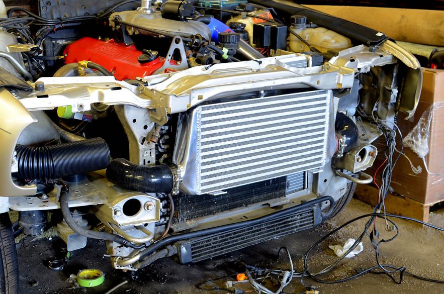

    Below is the intercooler being installed. Japanese Yonaka 18x9x2.5" with 2.5" piping. Very well made. I spent a lot of time looking for an intercooler and was lucky to find this jewel. The 9" height fills up the open space you get with a 6 or 7" high cooler plus this one is 1" shorter in overall length. The piping kit that I bought was kind of a joke........ way, way to many tubes. I could have bought a few pieces instead. I am able to keep my oil cooler, air conditioning etc.

    We got the car running and it is a real screamer. We keep the tune conservative with a rich mixture and not to much advance so I was looking forward to how it would run with a fine tune. After a short time the engine just did not run right, poor idle and erratic. I noticed that I was using gas like there was no tomorrow. To add insult to injury, the car started to smoke horribly with blue smoke. Due to the poor idle and the smoke, I pulled the plugs to do a compression check. When I turned it over to check #1, gas sprayed out of #6!
    Sure enough, the #6 injector was stuck open! I guessed that I had broken a piston or who knows what. We checked some more and found the turbo's shaft was sloppy (a brand new Holset). So, I ordered new bushings and will install them tomorrow.
    I wonder if the contaminated oil (gas) caused the turbo to wear out or what? Any recommendation for the size of the oil restrictor?

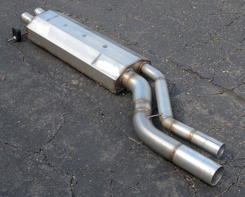

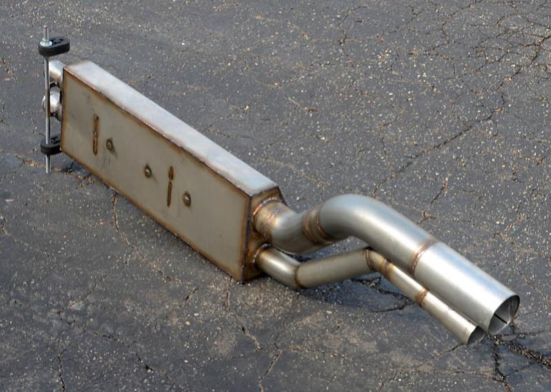

                Resonator built for my turbo build
                3" down pipe, 2" waste gate dump tube going into one custom built resonator. I had wanted to photograph the inside but my welder got ahead of me and sealed it shut. I put a few baffles inside. 2 - 2" outlets which will eventually go to a rear muffler (possibly custom built by me). 18 gage 304 which is fairly light. I am not sure if this resonator will make noise but if it does I will do something about it.
                Chuck

                      I run a OBX manifold, just make sure the flanges are flat so you don't get leaks. It will hold up fine. Very clean car my friend.

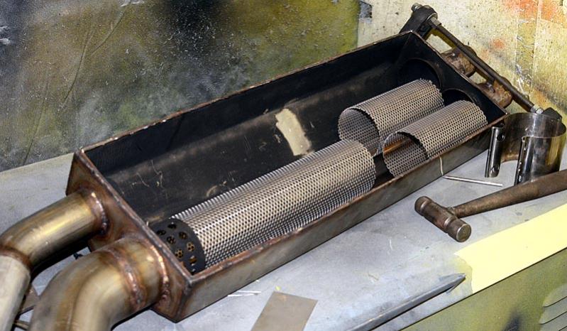

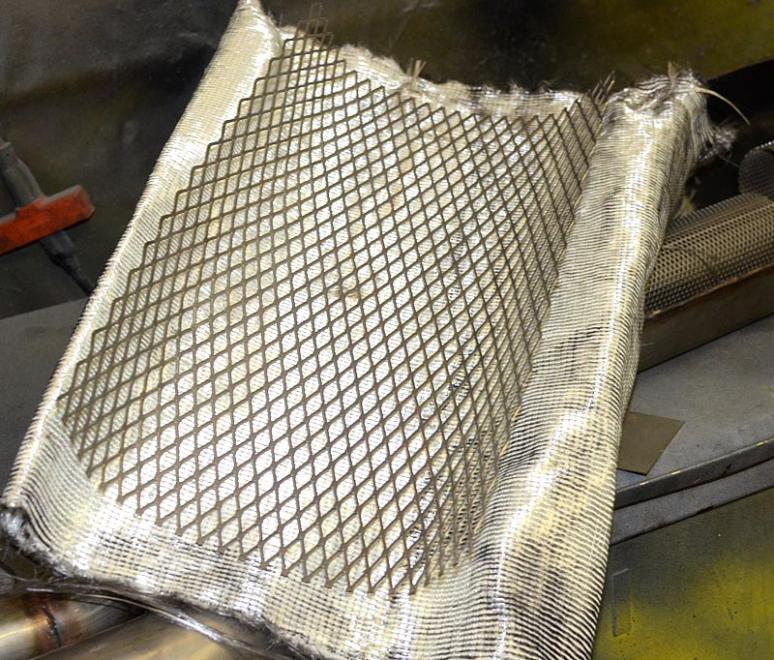

                        Resonator build = failure
                        Chuck
                        I finally got the car running and it really pulls :D
                        Big problem: The car is too loud for my taste so we cut the resonator open and will line the wall with a few layers of fiberglass and weld in the perforated tubes. The Perforated tubes will be capped off.
                        If any "muffler boys" have any better ideas, please post them. I have a little time left.
