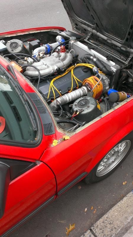

    Custom radiator hoses
    The upper radiator hose in my brother's e30 was handmade by the previous owner who built the turbo setup. Its essentially two different hoses that were cut and coupled together using the gnarliest and sharpest hose clamps ever and a piece of what I think is PVC. One of the hose clamps let go and I'm looking for a way to replace it with a single hose instead of handmaking another one by hacking up several spare hoses to make it work.
    The size of the radiator and the turbo placement seem to be the issue.
    Or is there some sort of slip on silicone or rubber sleave that goes over the hoses instead of between them and then I could hose clamp it down?

    A custom one piece radiator hose isn't really a feasible idea (they'd typically be done in a production-style setup, so you'd be looking at full production prices).
    You have 2 options (unless someone has some other ideas.
    1) You can fiddle around with short sections of silicone hose along aluminum or stainless tubing to get what you need. You'd need to get an exhaust/fabrication shop to put a little bead roll on the tube-ends (to keep the pipes from blowing off) once you've demod fit.
    2) Use a flexible hose like those found through jegs/summit.

      The stainless steel flexpipe looks to be the most straight forward method. Thanks

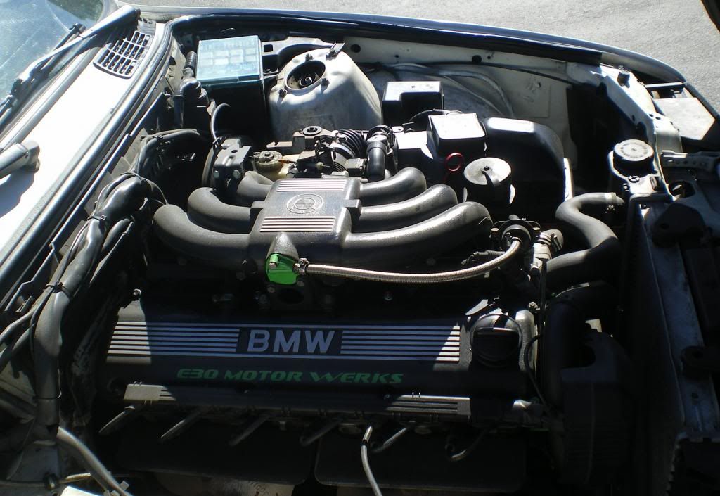

          Much cheaper and easier to just run an m42 radiator.

            I'm liking this idea since we would prefer to have the stock fan back in place, there's something wrong with our electric SPAL fan.
            Does the M42 radiator have better cooling capability than the radiator from the M20? Found a great deal on an S14 radiator from an M3, would that be worth using?
            We're having issues while the car sits for long periods of time after "enthusiastic" driving, temperature was going up into the 220's and climbing and I feel as though we're lacking a proper fan setup, even with the 16" SPAL fan in place.
            edit: just realized the benefit after looking at the photo again...integrated expansion tank!

              Its smaller then a m20 radiator but i'm boosting with no temperature issues.
