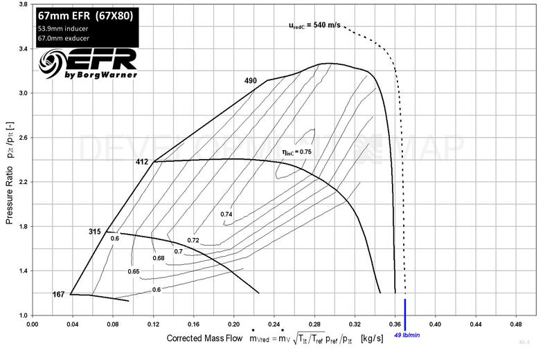

Cool shit! I need to know how the compressor map below will work out on my M50TUB28, stock cams, 8.5:1. What RPM will the boost threshold be at? When will full boost be realised? How many psi will I have at 2500rpm?
Thanks

To use a compressor map: figure out what flow your engine has at what rpm, and what psi of boost you want. The compressor map will tell you if you are operating in the efficiency range of the compressor. Some have rpm instead of flow on them which makes it a little more helpful.
If your size engine is flowing 250 cubic feet a minute of air at 5000rpm- and if you want 14psi of boost at 5000rpm, your engine would need to flow double that, 500cubic feet a minute at the compressor to achieve this.
500cubic feet of air at .0807lbs a cubic foot standard temp etc is 40.35lbs if you want to put a mark on your map there.
What the compressor map does not tell you is the cfm through your exhaust turbine.
Your turbine would also need to be getting rid of 500cfm of exhaust through your turbine, while also spinning fast enough to spin your compressor wheel at the correct rpm to achieve 500 cubic feet a minute.
There are programs that do this for you based on engine size.
That program gave me about 12.17kg a minute for a m20- converted to about 27lbs again if you want to use your chart. Remember my back-asswords calc above gave us about 40.

Now look at what car that is and realize that is just 1.8 liters with a borg warner EFR6758 turbo.
Interesting. Looks like if you are shooting for around 40/lbs a minute of flow you are well within this compressor efficiency.

Notice how the efr turbo goes out of the range at 49lb, but the holset keeps going. forever. At a 3x pressure it is 70lbs- almost 800hp at like 40psi is possible. Diesels are neat. Their turbos are neat-er.
