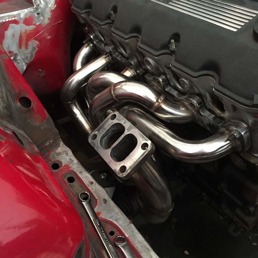

    Originally posted by Dyagciog
    All coated -test fitting
    I know this is late, especially since its running, but I'll bet a LOT of money that runners 4,5 and 6 do not line up to the head work a crap.....don't let the flange fool you. I have the same manifold....see below on how I had to fix it....

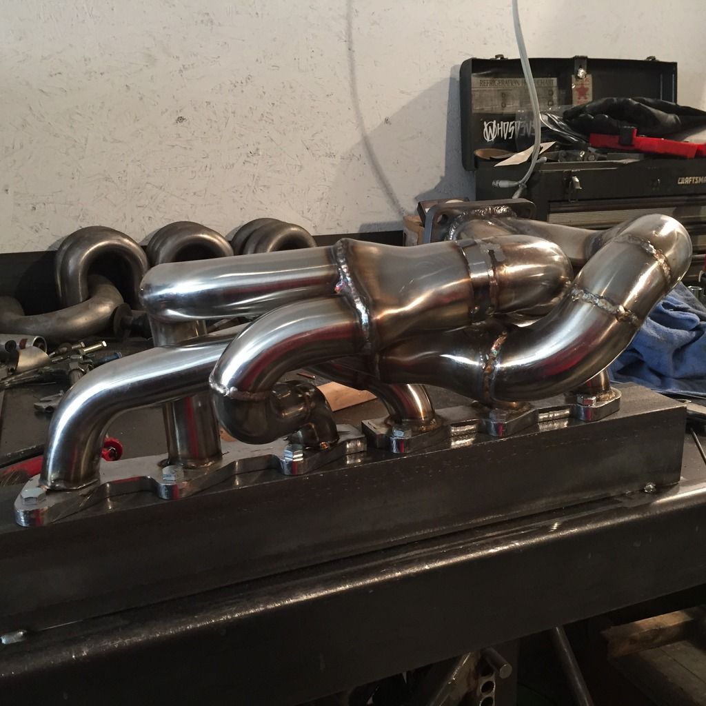

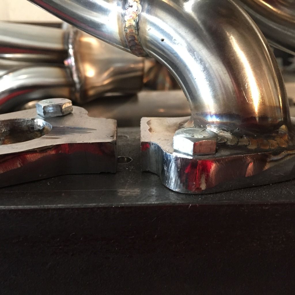

    Bolted to my jig, cut flange in half, cut back three ports.

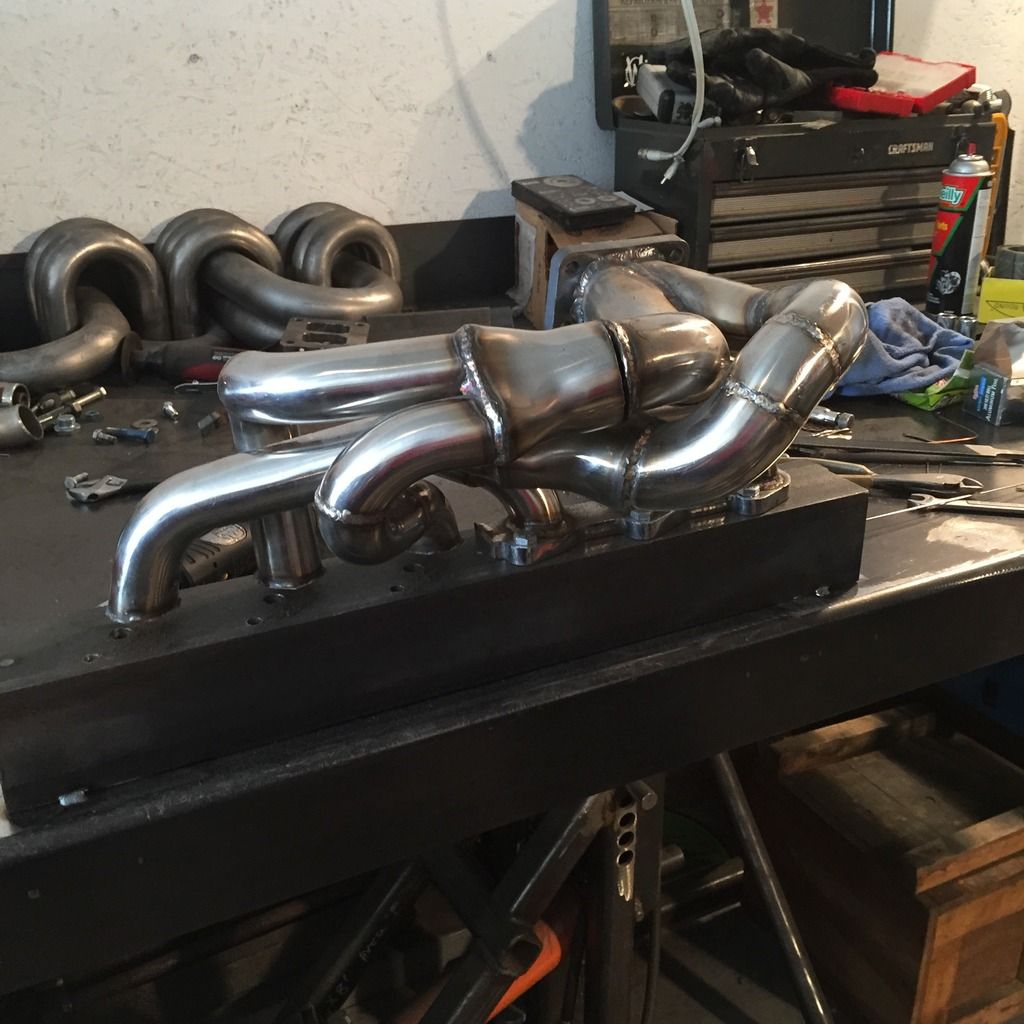

    Cut the rear 3 runners off at the end of the collector
    Bolted up flange to the jig.......Gap central son.
    Cut 2" spacer piece for the gap at the collector
    Flawless fit......even for eBay garbage.....
