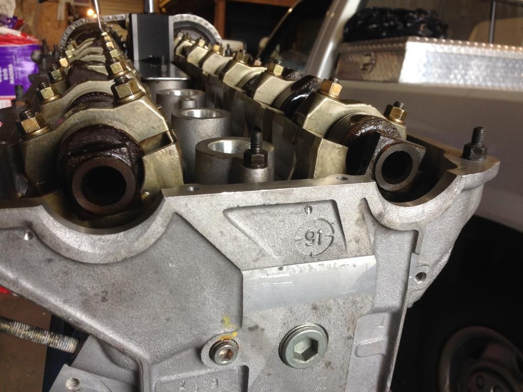

I've begun to degree my camshafts. My setup consist of M50NV block & head, with a S52 crank, M54 pistons, 135mm Non Vanos Rods, 0.140" Cometic Head Gasket and Dual intake cams.
It makes sense to me that the TDC is different from the timing marks. I know the exhaust camshaft block will not line up, because I'm using a stock non vanos intake cam in its place, but does it make sense that the intake camshaft doesn't line up like a stock camshaft because of the head spacer?
This is how the back my camshafts look with the intake set at 19 degrees BTDC at 0.050":
Rotated twice around verified angle and opening lift point and checked for interference and everything seems to work out. Is this correct?
