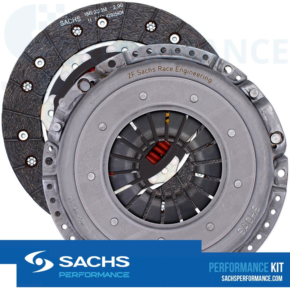

    Would this be the best clutch kit for a turbo e30? It looks like it uses the Sachs 618 pressure plate and a Sachs sport clutch disc.
    Diameter [mm]: 228 - Number of Teeth: 10 - Hub Profile: 23x29-10NTransmittable torque 350+Nm.Manufacturer compare numbersBMW1 223 0281 223 1021 223 1031 225 99821 21 1 223 02821 21 1 223 10221 21 1 223 10321 21 1 225 998
    I went with the tcd stage 2. After speaking with the tcd guy he thought the clutch masters 8-puck would best suit my needs for a 350-400whp weekend warrior. Having put 3k+ miles on it, it was a little grabby at first but now its not that bad. In terms of the weight, it feels about as light on the pedal as stock.
    I'm only running 10lbs of boost right now but i would def reccomend this setup thus far.

      Thanks man I should be making about 350hp so that sounds pretty ideal.
        No prob. If you are going to order from TCD I would call him and let him know you are interested in the 8-puck clutch so he knows to order that specific clutch for you. He had me put 8-puck clutch in the comments of my order but I had spoken with him earlier that day as well. Just a heads up.
