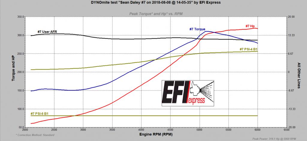

So finally made it to the dyno this past wed. Everything was going great. Had some issues making to much boost due to routing the lines for external waste gate to the wrong ports on the ebc. Ended up getting it squared away. Then realized we blew a coolant line. Not a big deal right? Repaired and tried again. This time coolant trying to blow the rad tank cap off. . . . figure its obv head gasket.
Question is what is the best setup or brand? The one that we popped is cometic mls. .080".
Its running 6lbs of boost with hopes for more and put down 320whp.
Let me know what's out there.
Yes it has arp studs
