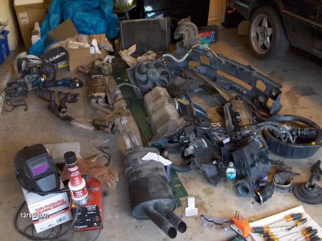

    During the tear-down I replaced the headgasket, timing belt, waterpump, thermostat, and tons of other stuff.

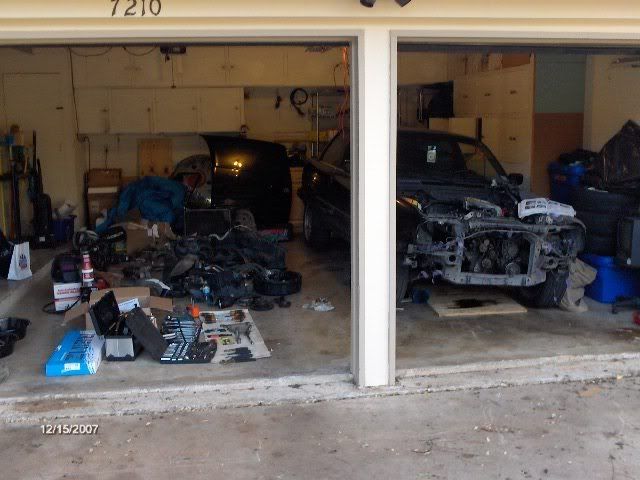

    Here's some pictures:

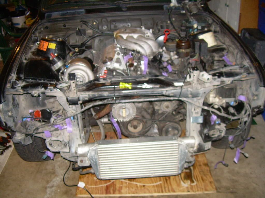

    During teardown:

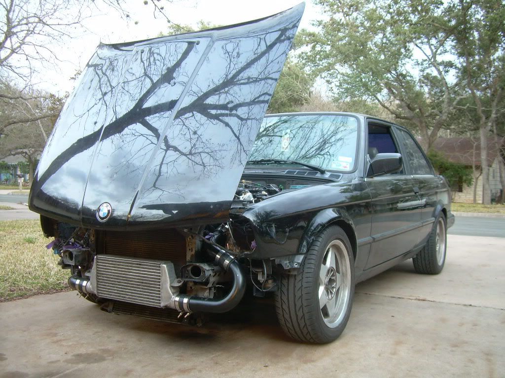

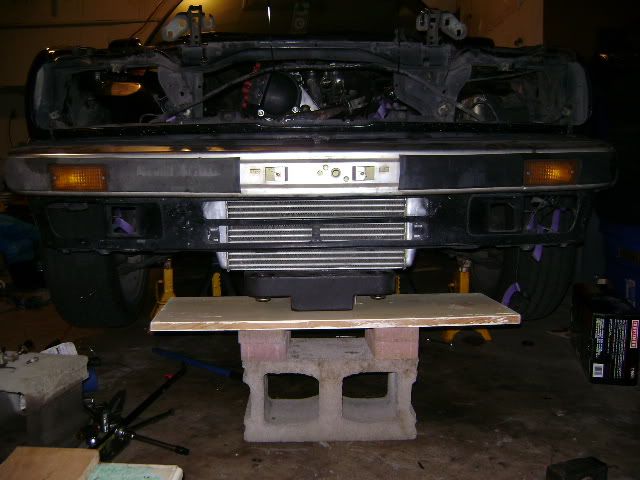

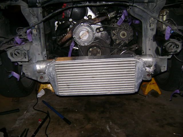

    Fit the intercooler. It hangs really low now that I look at the picture, so it will probably get flipped. For now it'll do fine.

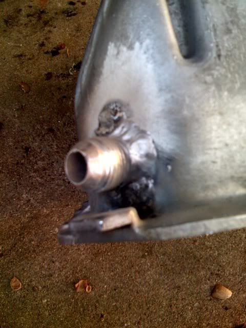

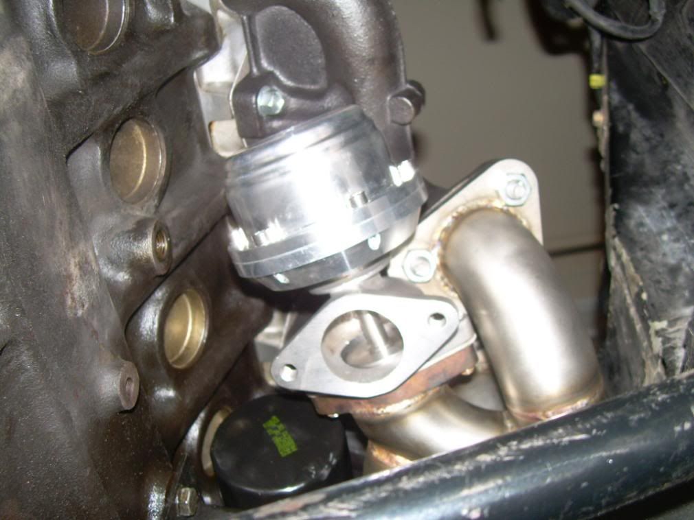

    A friend with a tig welder helped me out by welding the bung for the oil return. He did the best he could given the shitty situation. Does anybody see anything wrong with my placement??
    With the bung welded in, there is no way you can screw in the bolt that goes directly above it! I'm going to wait and see if it doesn't leak with 24 bolts instead of 25. This is a big learning process.

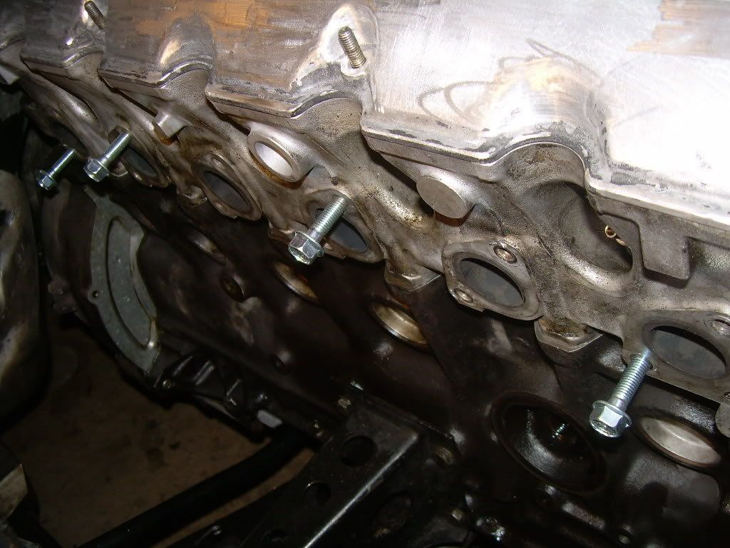

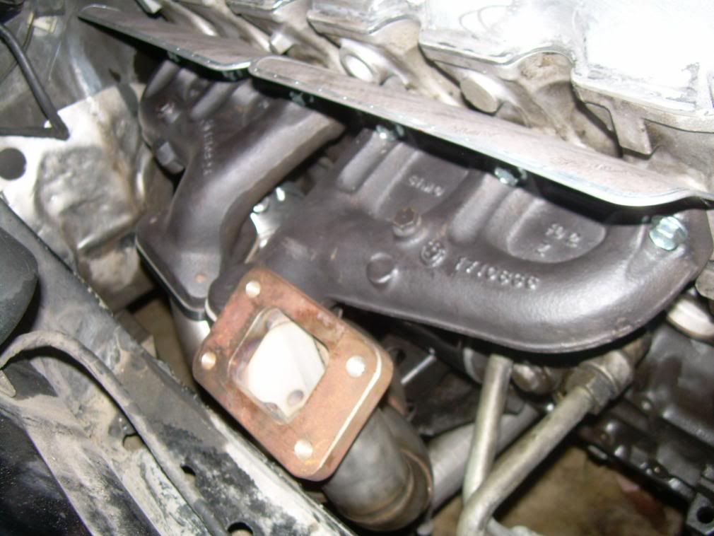

    Fitting the manifold took a while. I had to switch from studs to bolts because I couldn't fit the it on.

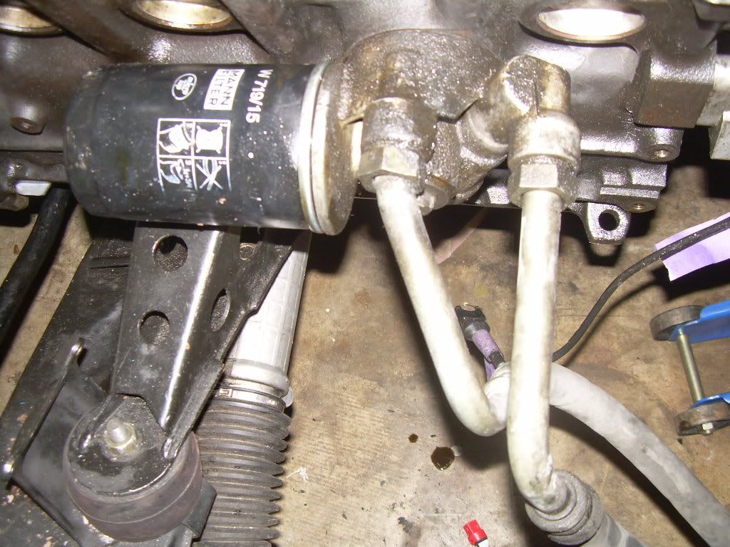

    Also bent the oil cooler line for clearance.

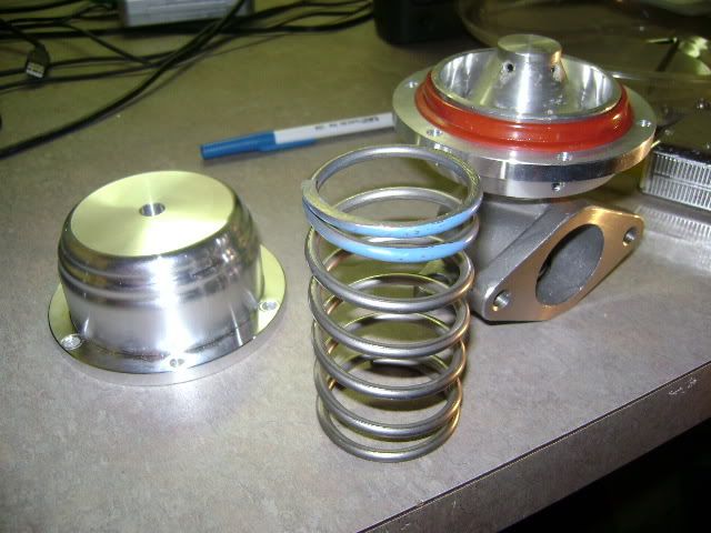

    Knock-off tial with authentic 8.7 small blue tial spring:
    I bought it from a friend who had bought it from somebody else who said it was a Tial. I opened it up and realized it wasn't. I'm sure it will work fine with a good tial spring.

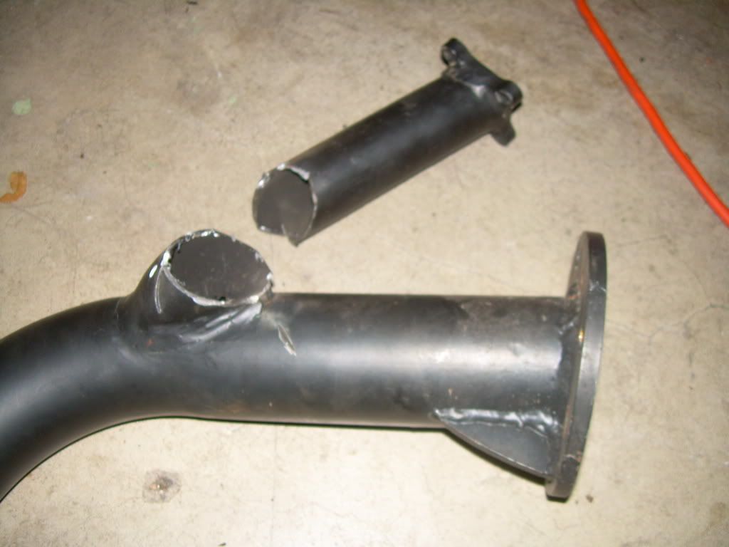

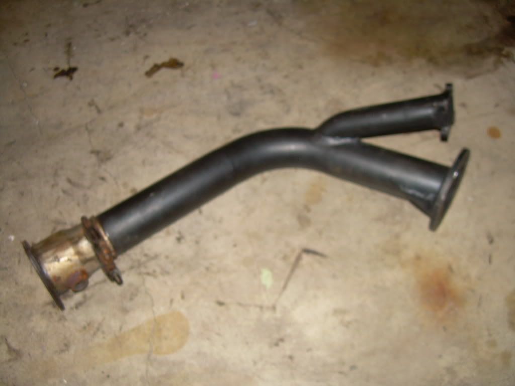

    Bought a downpipe for cheap from somebody on e30tech. It fits OK, but it will need a little modification.
    For one thing, the WG piping needs to go!

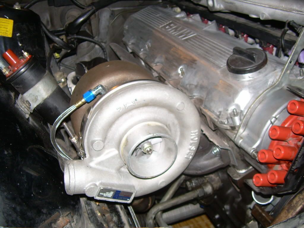

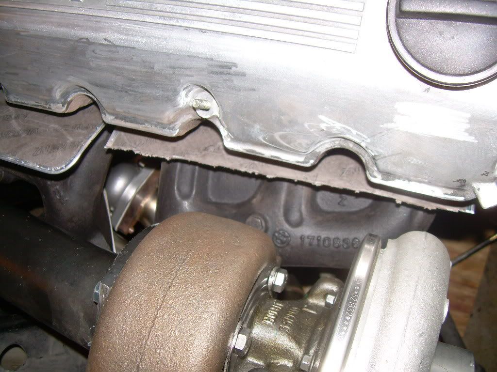

    Turbo installed. Looks fucking good.
    Trimmed exhaust gasket for clearance.
    How she sits now:

            You need to clock the turbo feed/return better.

                Yea, I will be. I'm going to be unbolting the turbo and installing the drain as soon as it comes in. Right now it's just there for downpipe fitting/charge pipe fitting. Good tip though.

                And yes, very much so. Everything is horrible about this return bung. It will probably leak, in which case I will use yet another oil pan I have lying around with a proper bulkhead fitting.
