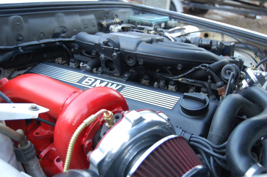

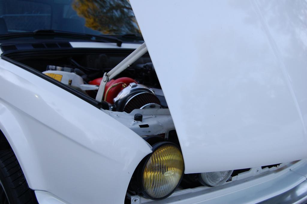

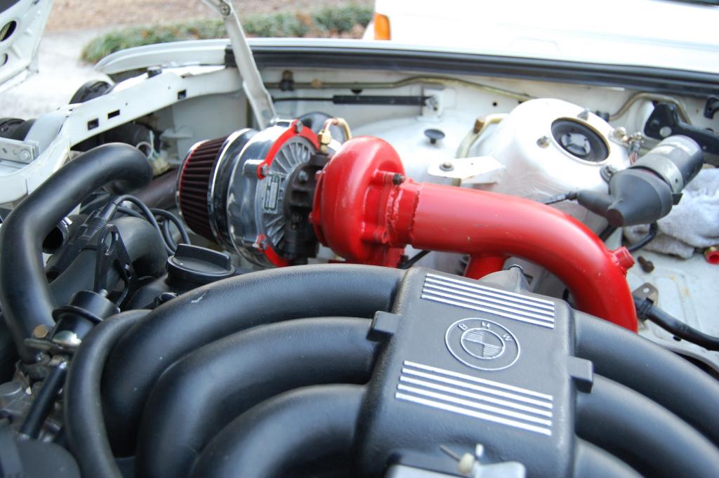

test fit
  • TS87325IS
    • Sep 2006
    • 821
    test fit
    coming along:D
    mods: just meat and potatoes under the hood and wheaties on fire out back ;)
  • Jbpka06
    • Feb 2006
    • 551
    the red is little ridiculous..
    what manifold are you using and what are you going to use for management?

      Wher'd your resivoir go?

      • TS87325IS
        • Sep 2006
        • 821
        not finished yet , I like the red , it was better than silver , its just vht ceramic coating , I am going to wrap it still and put the reservoir on the drivers side , still have a bunch todo , and its a country boy exhaust shop homemade deal that fits pretty well , we will see , it will work untill I can afford a 666 manifold , I am running motronic for now with a begi , just going to stick with 8 lbs for now. I want vems but might settle for megasquirt.

          the red just says, "in case you didn't notice, i have a TURBO."
          but to each their own. i wish i had a turbo. i'd rather have a red one than none.

            What turbo is it? Do I see Garrett tag?

                I cant find the exact part number to tell exactly what it is , but it is a garrett and as far as I can tell and what I've been told , it is a t4 to4e .60 on compressor and .84 on exhaust , its pretty big looking:D. I have been trying to keep from cuuting anything and trying to keep everything in stock location just incase I go back to na , but I don't think its happening. still a big learning experience for me I am a turbo newb , but a happy one at that.
