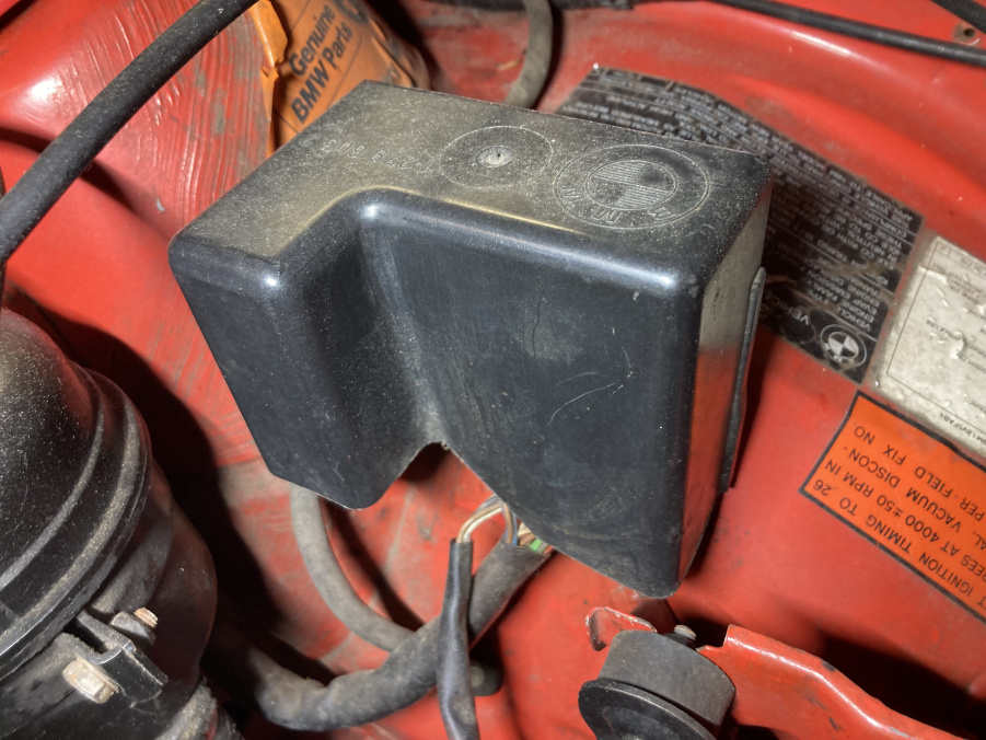

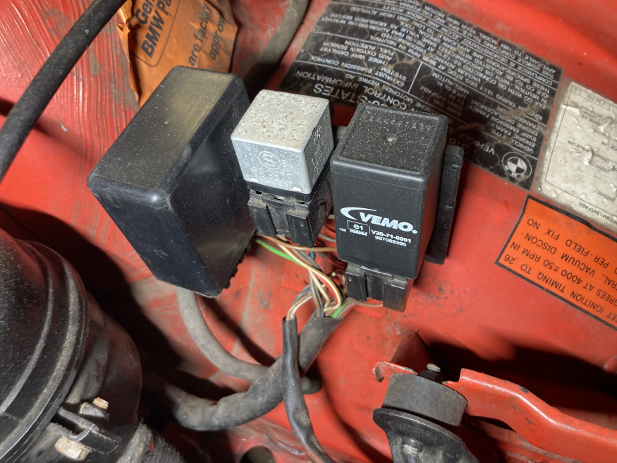

    Hello I've recently bought a 84' 318i the car had set for a number of years and has had many different parts taken from it so ive come here for help.
    I bought a new wire harness which it was missing we were able to get mostly everything plugged in and this got the car to crank which is a step in the right direction,
    However it is not getting fuel or spark i currently think the spark issue is due to the ignition control module not being plugged in however, it will be soon since the harness i bought had the leads for the siemens/Telefunken ignition control module and not the Bosch one that came with the car.
    This being said I'm now going to compile a few pictures of different wires and plugs that have me stumped so if you recognize or can tell me what any of these things do it would be of great help to me.
    Thanks!

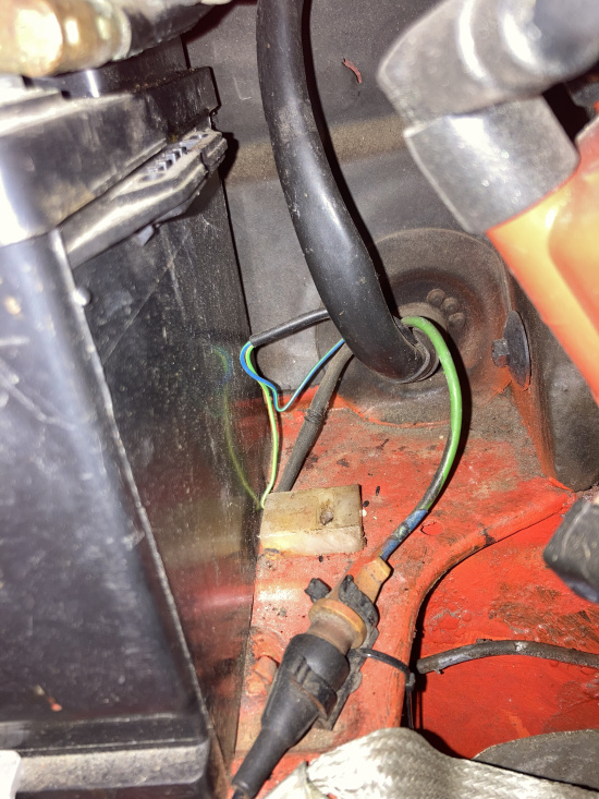

        In your third photo the blue/green and yellow/green connect together. Photo from my 84 318i

          In your first photo are the connectors for multiple relays positioned on the left inner fenderwell. The Vemo is the fuel relay.

            The connector in your 1st picture with the heavy red wire is for the main relay.

              For those 3 relays what is the larger one on the left with the big 12 pin plug? thanks
              • BadDays
                • Dec 2024
                • 185
