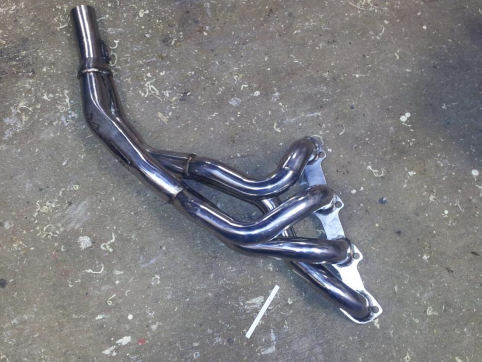

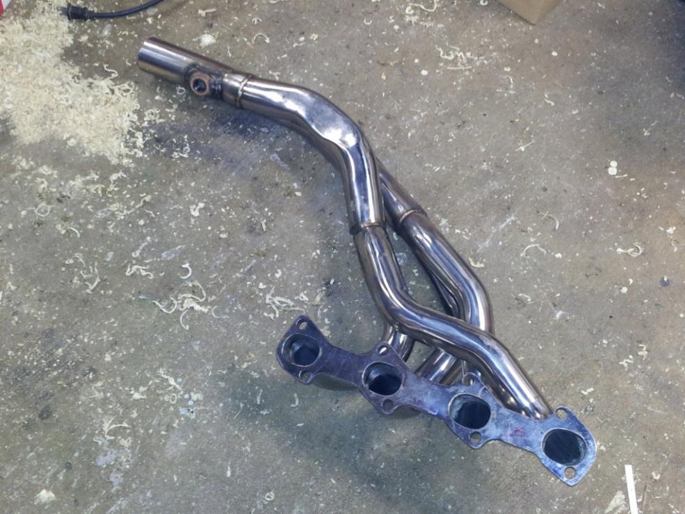

                        Well I'm not sure if anyone is still linked to this thread but I managed to find a header on CL in my area for $200 for the 318i. Thought it was a good deal, solid stainless from top speed performance. Glad I went that route though, even though it was supposedly car specific I still had to do a bunch of bending and flattening to clear the Trans housing, sway bar, Trans cross member, and engine mount. Then I had to make my own ox bung setup. So beware when you buy one, even if it is car/model specific. I will post pics soon. I should have it finished on Monday or Tuesday. I'll let you know how it works out when finished.

                            #58
                            Ok, here the pics. you can see in the pics what I was meaning by the fact that I had to flatten out the header.
