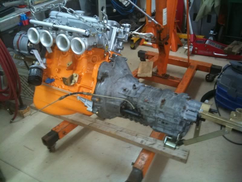

                        Originally posted by harv View Post
                        John
                        :up:
                          #42
                          ^----I agree with that. Beautiful engine and ITB's. But...please throw that transmission in the parts washer!
                          85' 318i ~The Bronze Bomber (FrankenM10 with a Forced Future :wgaf:)
