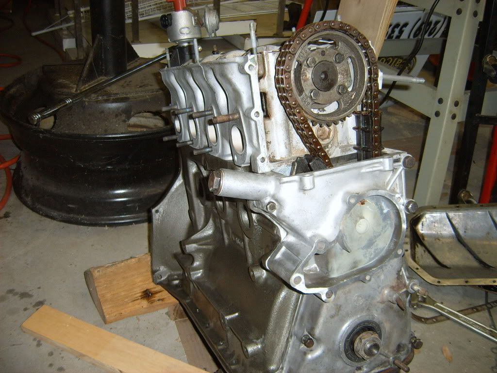

              On another note, I brought home some parts to check things for the b20 block w/piano pistons mating with the 318i head.
              Boom, TDC with the baby grands sticking above the deck.
              Head set on, TDC as well.
              I was able to turn it by hand (with ratchet) and did not feel any interference. Just to make sure, I rotated it SEVERAL times.
              Then I got bored, and sat some items on to see what it'll look like.

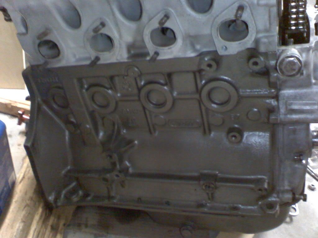

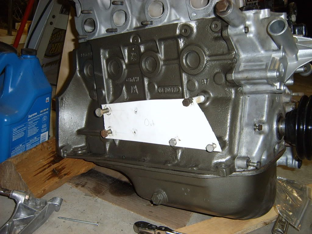

                          So I started on trying to find a way to make my mounts work, this is what I am coming up with, I doubt I will run a/c, so I don't need the bracket that usually goes in front (will have to make sure nothing else bolts to it). I'm trying to figure out how thick of a steel plate I will need (was thinking something around 1/4" thick). Haven't looked into the other end of the arm yet, may need to make an adapter plate to go to the motor mount as well depending on how much the adapter plate relocates things.
                          Mounting spots on b20 block
                          My Idea
                          With the mount sitting where it's supposed to be
