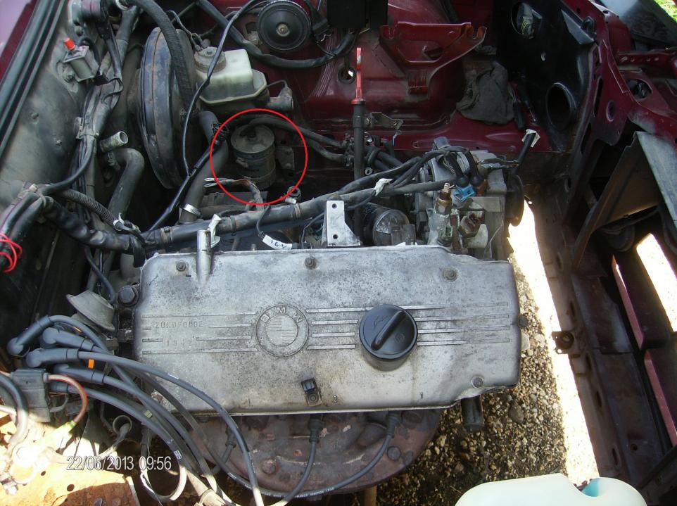

          Fuel filter location (see pic)
          The thing before the pump is supposed to be there , I think is some kind of pressure regulator , I think.
          The thing after the pump , I have no ideea , I have no such thing on my car.
          • thebutterson
            • 463
            I think those are to even out the pressure surges. Fuel filter is definitely located as shown in Tzzantaru's picture.
