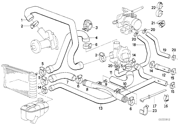

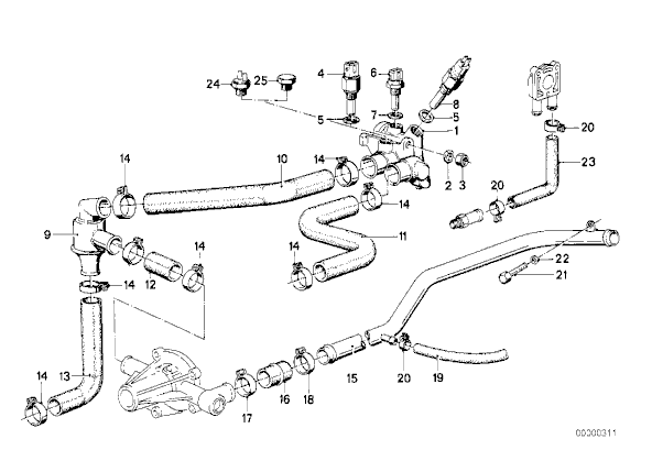

    Alright i've searched around and can't find much. Just a lot of off topic stuff.
    I have an m20 radiator that is a year and a half old so i'm swapping it in with my m10.
    My question is with hoses.
    The upper m10 radiator hose is not long enough to connect the water pump and m20 radiator.
    Then the m20 upper radiator hose is not the right shape to connect them.
    I'm ordering quite a few new hoses and was wondering if any of you used another engine hose, I just want a better fit and nicer look. No kinks or any of that.
    #4 m20 hose

    #11 m10 hose
Name:	e30 m10 cooling.png
    Any input welcome, thanks :)

    How are you going to fill and bleed the system? The m10 fills and bleeds at the radiator cap. The m20 uses an overflow tank to fill and a screw on the thermostat housing to bleed. Seems like you're gonna have to do a lot of work just to reuse a radiator.

      It's not really hard. I've seen a few threads taking about "T'ing" off a hose near the thermostat or just tapping a screw in it.
      My dad ( a growing mechanic of 30 years+ ) see's no problem with it. The radiator has literally under 1000 miles. Timing belt snapped.
      I'm just trying to see if people have found an upper hose that has the length-diameter- and shape. I know its been done.
