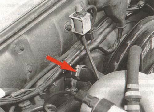

        okay so im looking into the work needed to do the heater valve and i noticed i start by removing the upper hose in the engine bay... Well i mine is cut and have no idea where its supposed to lead. Click image for larger version

          Originally posted by 85.318i
          yes!the floor is wet actually. i was wondering how it got wet last night. i tried smelling it to see if it was coolant but couldnt get a good wif. any links or tutorials on how to fix this? i really dont want to have it hauled somewhere to have it fixed. i have very little $ in my pocket and in the car.
          also i just tried it again and the top tube out of the radiator is hot while the lower stays cold...
          I don't know of any diys.
          if the bottom hose stayes cold then your thermostat is no good
          • 85.318i
            • Nov 2013
            • 9
            okay thank you Oliver! im going to pull my hoses from the radiator and run a garden hose through the top to see if the radiator is clogged first
