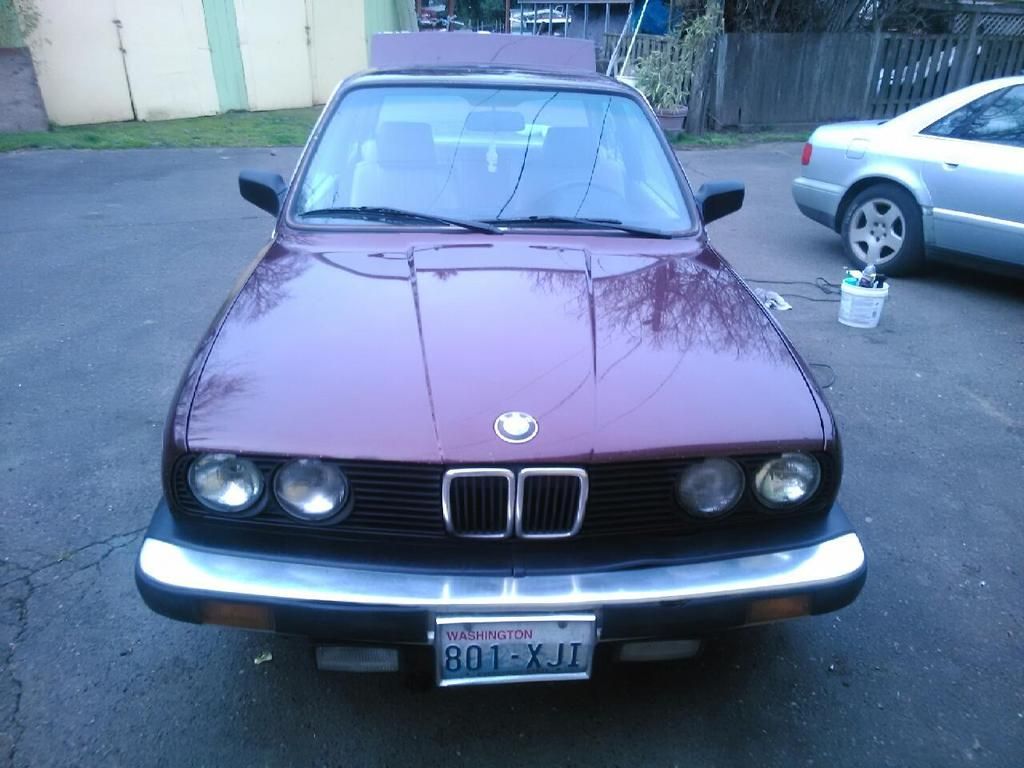

    So a few weeks ago I traded a clean 87 190e mercedes for this sweet little bmw
    It came with a brand new battery and a no start issue, being super clean rust free etc I took on the possible nightmare of a project.
