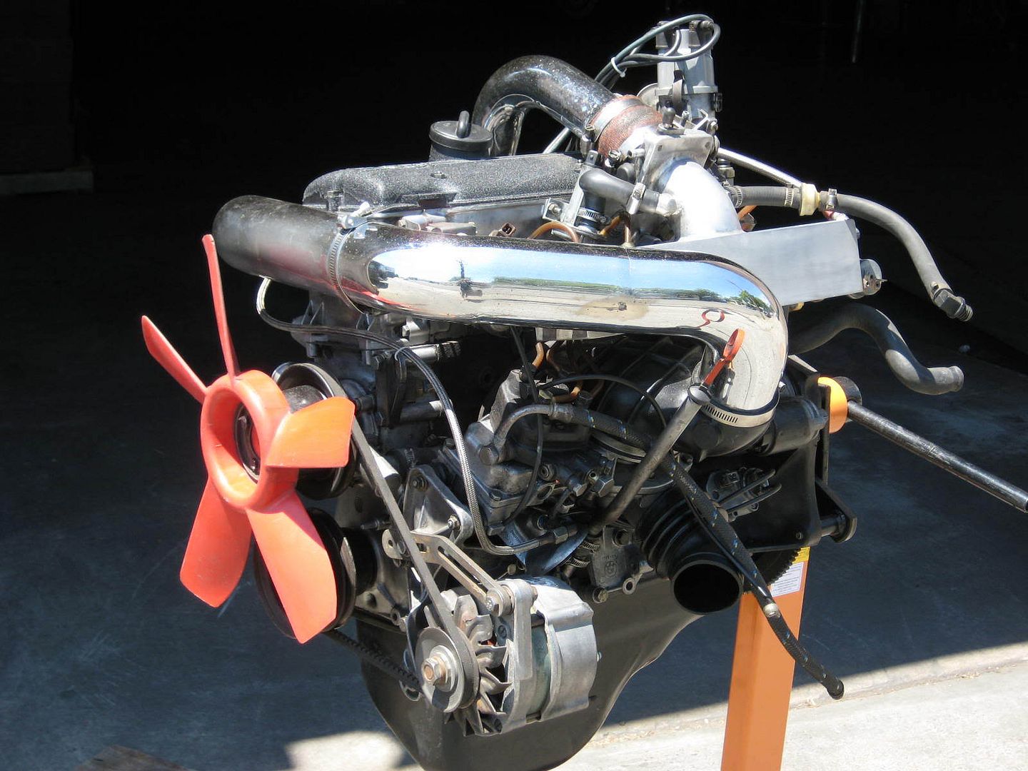

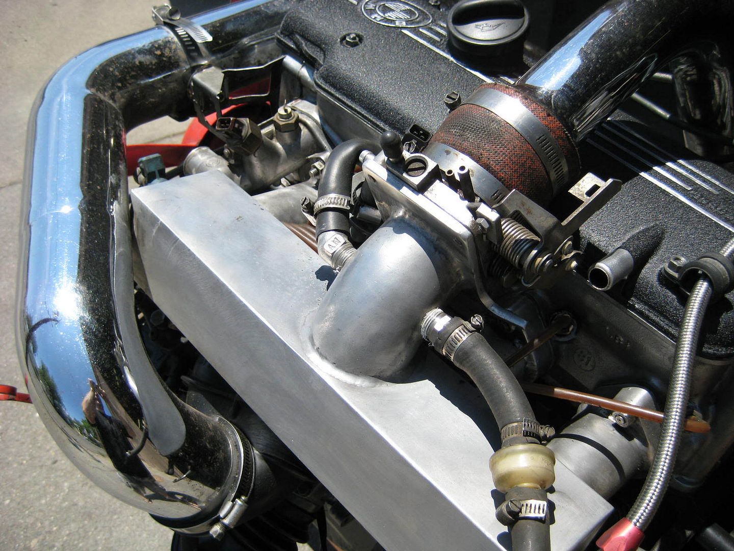

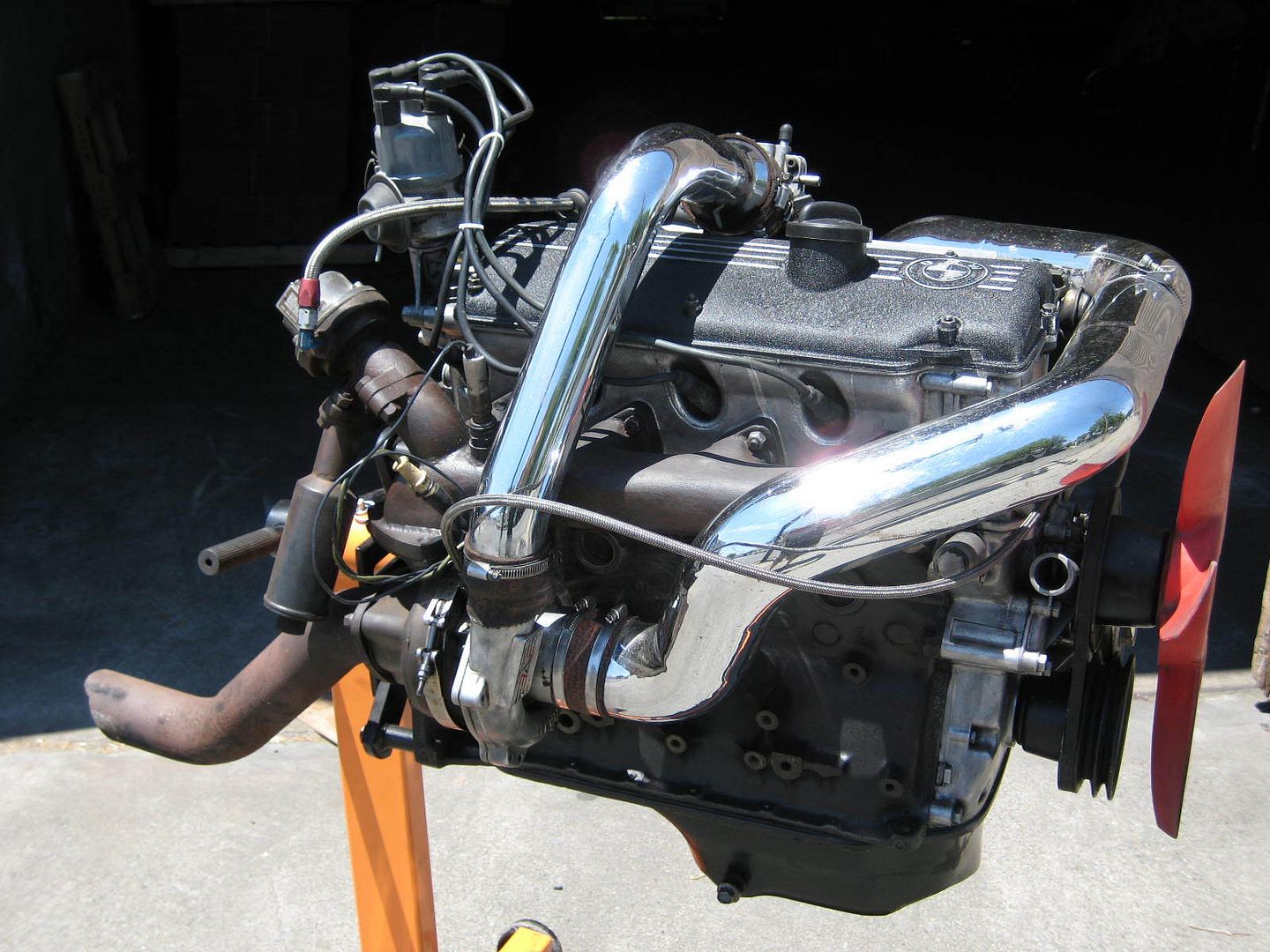

    Hey,
    AFter researching a good deal of Turbos and such, and deciding to take my 2002 in that Direction, I finally met up with someone who had built a turbo motor from an e21 to go into his 2002, low and behold he built another motor, and I will most likely be aquiring his old turbo motor.
    As you can see from the pictures it is a 1.8L turbo'd motor with the
    Jet-tronic.
    He is supplying me with everything I need to just drop the motor right in, and pretty much be ready to go. (I know its not THAT easy), however I thought I would run some Ideas, and questions by you guys before I jump the gun.
    First off. Its got the stock e21 fuel managemnt system, with some RRFPR, etc. needed for the turbo. I know this HIGhly hinders the m10's capabilities, but the fact that it is ready to go is really appealing. So obviously I would like to megasquirt, and I am pretty sure I know what it takes to megasquirt (friends are good with the tuning etc.. of the system), yet I think I might be missing out on somethings to convert the Jet-tronic to full standalone. I am trying to weigh the pros and cons of going megasquirt vs the conveince, and potential performance
    What is the potential performance of this motor with the stock system?, remember tht I dont have to smog it at all.
    I also am wondering If I should intercool it, would be hard to do a radiator intercooler, or mayber a top mount with a scoop, like teh subarus
    [/url]

    It depends on your power goals. That setup is fine if you're looking for 200hp or less. This assumes the addition of an intercooler for anything above ~7psi(150hp?). Above ~200 and you need a larger fuel distributor. Assuming you got more fuel the manifold and turbo still prevent you from going above 225-250. The manifold also limits you to stock or close to stock cam profiles due to backpressure. Kjet really isn't as bad for turbocharging as everyone thinks. There are many oem kjet turbo parts you can use. Any kjet turbo would benefit from a boost referenced WUR found in an audi 5k. Kjet pumps are interchangeable, so- should you surpass the stock 320i flow capabilities, a volvo turbo pump or a mercedes v8 pump will bolt right in. Volvo boost retard canisters will bolt right on your distributor.
    http://forums.bimmerforums.com/forum...play.php?f=143 several guys on there are kjet turbo. Also check out http://www.k-jet.org/
    It really depends on price. Think about what you're paying for- Manifold, turbo, wastegate, downpipe, charge pipes, and it has a special intake manifold that puts the throttle over the valve cover to shorten piping with the lack of intercooler. It also has oil lines.
    The intake manifold you'll probably end up ditching in favor of a stock piece when you get an intercooler. The stock manifold makes pipe routing better, and is a better design overall. Then the charge pipe with the kit won't be any good to you. The fuel system is stock and will likely be upgraded. So you're buying a manifold, turbo, downpipe, and oil lines. The manifold and turbo would, at that point, be the weakest part of the system. It's kind of hard to justify with full length tubular top mount turbo manifolds going for ~$250 shipped on ebay. Those manifolds spool a large turbo faster, allow you to run a real cam with more aggressive ignition timing, and all around make more power. Then you could get a turbo that wasn't designed 30 years ago. Power levels being equal a proper manifold and turbo will be a lot easier on your engine.
    I guess it depends on what you can get it for and how much power you want.
