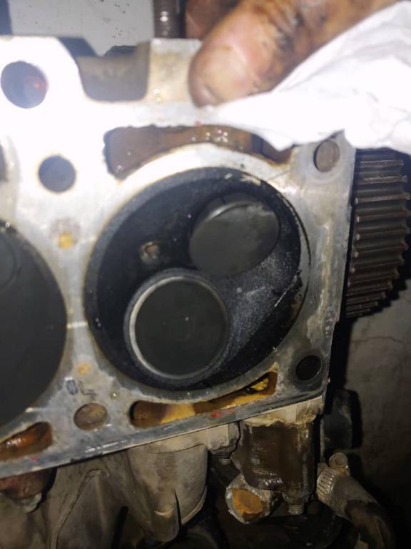

        I popped the head and this is what i found oil on cylinder #1 and i believe that intake valve is a problem what is causing this piston contact or valve is not closing properly?
          I think I recall seeing elsewhere you posted about machining some material off the head. Did you do a putty check during reassembly to validate valve clearances? Do you know how much material was originally present and how much was taken off?
          I can't tell from that photo what state the valve is in; it seems somewhat low resolution or maybe slightly out of focus. Does it look like it contacted the piston? Is there a corresponding mark on the piston?
            I checked the piston and confirm no marks.
            yes head was milled far beyond specs and oem hg used.
