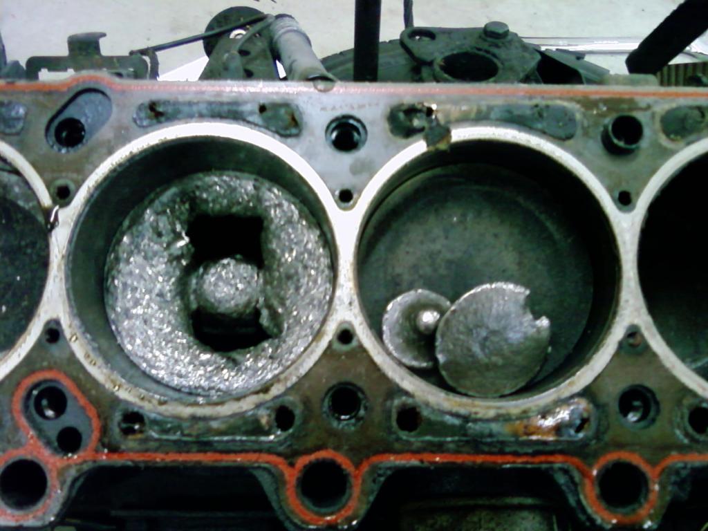

No thats not melted, just a crappy cell pic. All the pistons were hit by the valves. But no. 3 vales broke lose and the PO kept running the car. the head looks just like the piston.Comment
Damn
that is crazy, I just cant get mine to reev over 1200 so I picked up another M20 and tranny and E block to build a stroker and have a spare motor so I am in the process of cleaning the blocks and prepping everything. Muppet again thanks for the info man I appreciate it.
JoshComment
you could reuse the block, even if it meant a sleeve, but Its probably not worth it $$$$ wise when you can pickup another one so cheap over there.Just a little project im working on
