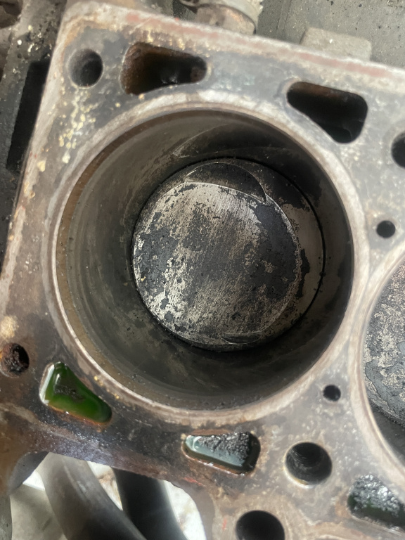

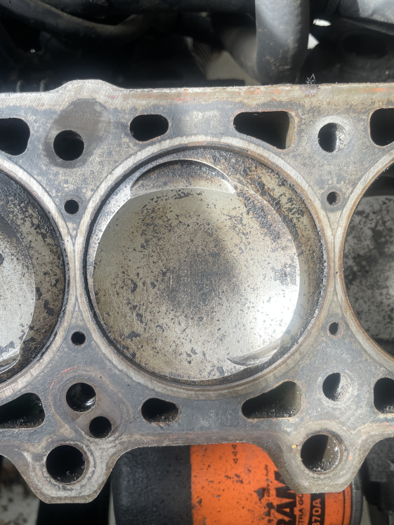

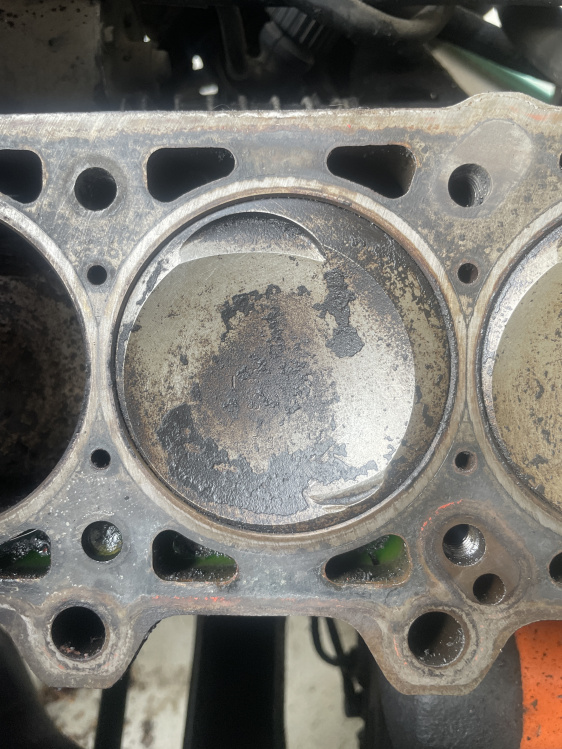

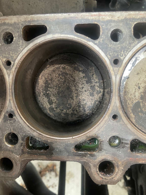

Is this repairable? Or would it be better to find a new head?
  • bronzitsedan
    • Jun 2024
    • 16
    Piston 3
    • bronzitsedan
      • Jun 2024
      • 16
      Piston 4
      • bronzitsedan
        • Jun 2024
        • 16
        Piston 5
        • bronzitsedan
          • Jun 2024
          • 16
          Piston 6
          • E30SPDFRK
            • 5697
            Ok, those all look fine. Some of the photos looked like piston 4 had the imprint of a broken-off valve head imprinted, but it must have just been debris. It does look like that engine might have broke a belt in the past judging from the little burrs on some of the exhaust valve reliefs. I would clean those spots a bit with a file, sander, or razor blade, but other than that they should be good enough to reuse.
            The spots I'm talking about are on pistons 1 4 and 6, possibly others but it's tough to tell with those photos.
            Byron
            Leichtbau
