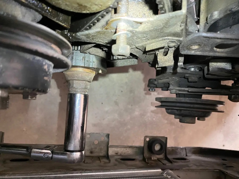

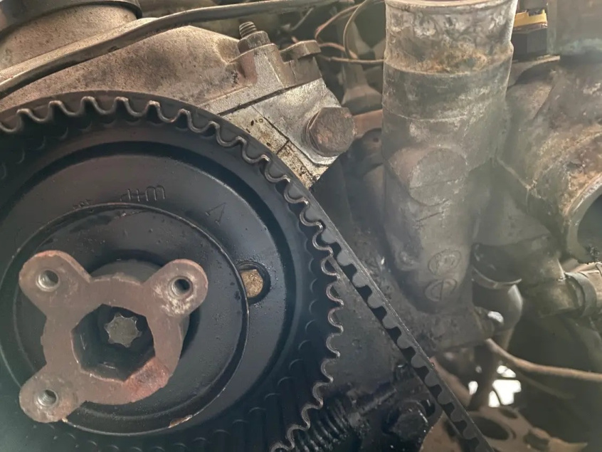

    • I had an issue when removing/installing the cam gear, where the crank would move out of time vs the cam gear. Posted on the r3v FB page, and was told I could move the crank independent of the cam as long as I wasn't hilariously out. I wasn't hilariously out so I did just that to get both crank and cam back in time.
    Click image for larger version  Name:	IMG_2350.jpg Views:	0 Size:	189.7 KB ID:	10123502Click image for larger version  Name:	IMG_2349.jpg Views:	0 Size:	185.2 KB ID:	10123503

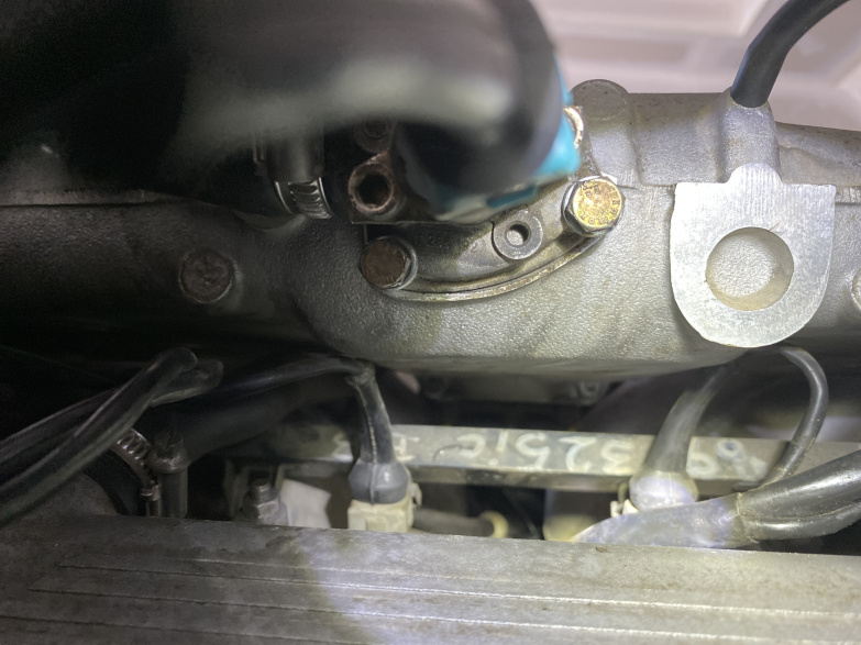

    As an update. Forgot the 2 screws holding the cover for the cold start valve to the intake manifold over the course of all this. So the car was losing air metered by the ICV and running with a terrible burn (you could smell the unburnt fuel at times). Reattaching the bolts fixed the idle and it rests at ~700-750 rpm now. So uh, assembly fully before testing lol.
