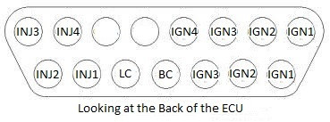

    ive been going at this for a while , need to know if anyone is still running a whodwho megasquirt ecu ,
    ive wired both the launch control and boost controller as shown in the diagram now with my msq file the drop downs in both i dont know what one to select
    pe0 - i set on the boost controller and it works in the output test but looking around people say thats for launch control which will not work when i went to t/ engine off and tried to see if it enables .. ive looked through diff msq files on his google docs but i cant figure it out or how i go about adding an output if it is missing as i did not use his msq files to get the settings dialed in and running
    im going to tune the car but want to have everything correct before wasting my time and money
