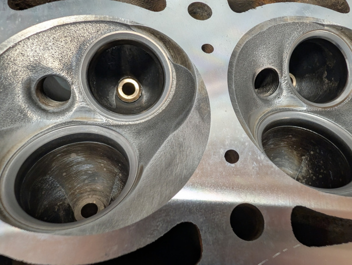

    Put my 885 head in to get new exhaust valve guides and 3 angle valve seats cut.

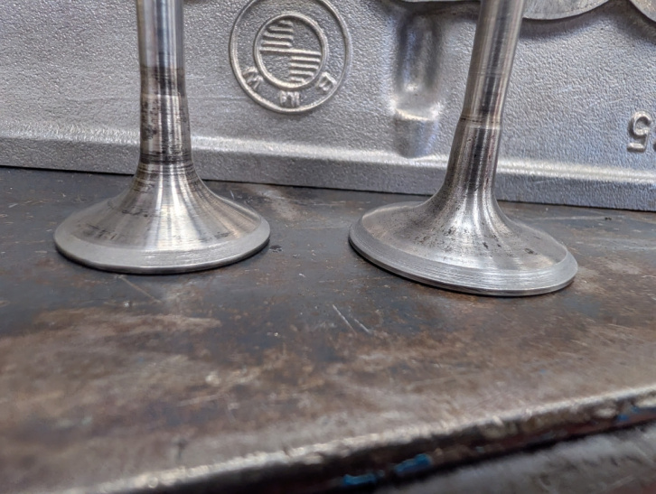

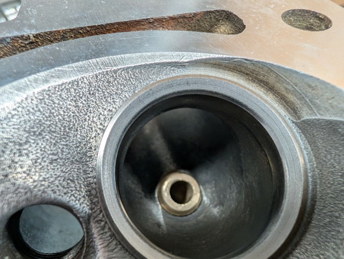

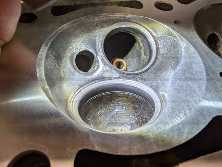

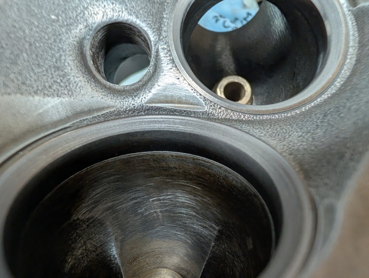

    After picking it up I’ve found 3 of the intake valve sealing faces to be concave, and all the intake valve seats have grooves round them.
    Spoke to them and they say their cutter is a bit worn (think they use a Serdi), and are going to get a new one and recut them.
    I can’t see 3 angles on the valve seats, it just looks like one big angle to me? May be wrong as I have nothing to compare to.

    I see only two and daaamn those grooves

      Seemingly impossible to find competent trades for anything. They tried to say it's fine as it holds a seal, I argued against it.
