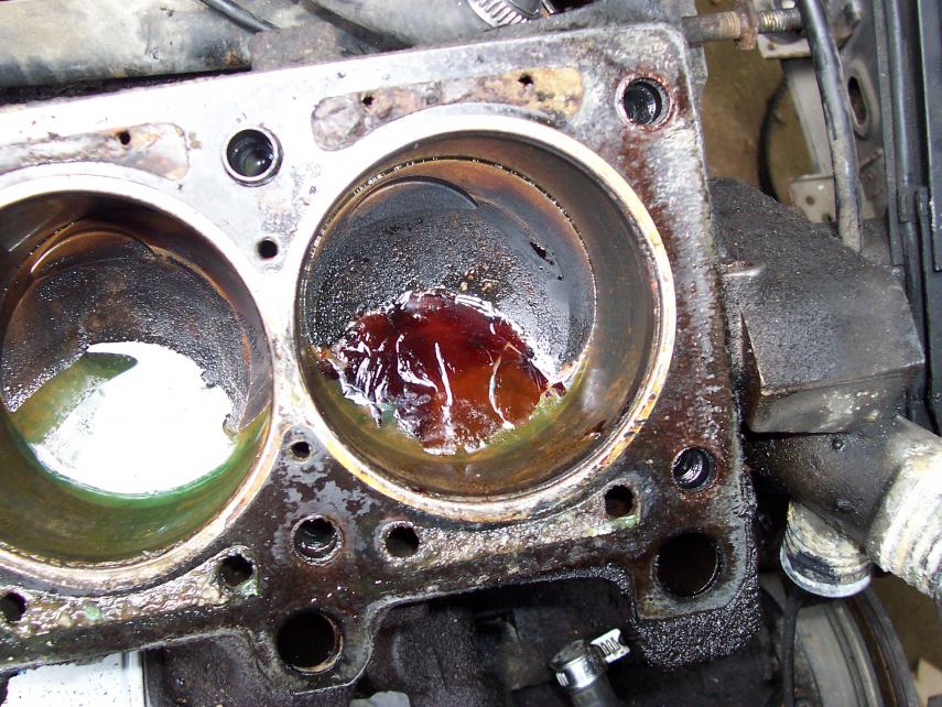

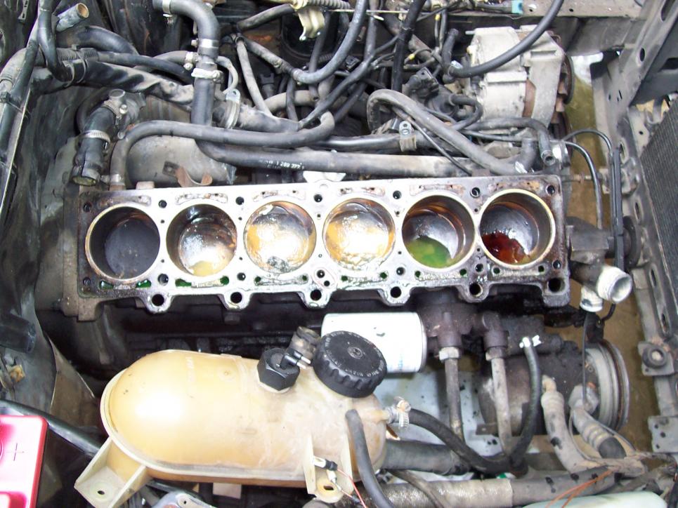

    Hello all, this being my first post and the fact that I am new to BMW's please excuse any blatant errors because I am a noob. So here is the story: I picked up an 87 325 ic about five months ago with the intention of eventually rebuilding the motor, tuning the suspension, slapping on a turbo, etc. The motor ran ok when I got it, the original ebay post said rough idle but revs ok. When I picked up the car it was more or less in the shape that I figured it would be for 1500 bucks. Managed to drive it back 300 miles and do a compression test before it blew something big. Wouldn't rev past about 1800 rpm, had no power what so ever. Started to do a plug check and noticed a high pitched noise coming from one of the cylinders and sure enough, head gasket was blown.
    Started tearing things apart last weekend and went to drain the coolant. Barely anything came out which made me think, where did it go? Found some of it when I drained the oil pan, chocolate milkshake anyone? Found the rest when I pulled the head off, turns out my motor had turned into a steam engine. Long way to go still, in the process of looking for a good machine shop right now. Anyway, thought I would share with ya, any comments, questions etc are appreciated. Any specific know how on things to look for in M20 head rebuilds would be great. As soon as I get a chance to post pics I will do so.

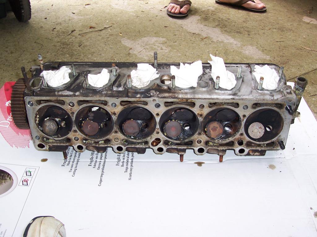

                      Ok, can finally post some pictures. Not sure why it wasn't working before but anyway, here ya go!

                        That's cool - All 6 cylinders have a different color.

                            Yeah the only one that wasn't totally effed was #6. Thanks for the welcome!

                              Well I bit the bullet and sent the head in for some machine shop work. $220 bucks for crack check, disassembly, cleaning, decking and reassembly was what the guy quoted me. Not too bad I thought so I went with it. Now the problem is that the cam and rocker arms are fairly worn and need to be replaced. I actually thought that when I did the first valve lash adjustment on it but as I hadn't seen any other M20 cams before I had nothing to compare to. Anyway, now I am out another few hundred bucks for a cam and rocker arms but oh well, at least they will be in good shape! I will post some more pics of the refurbished head when I get a chance, probably mid next week.
