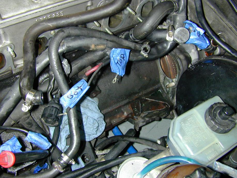

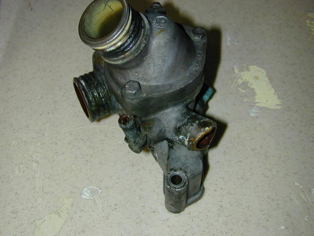

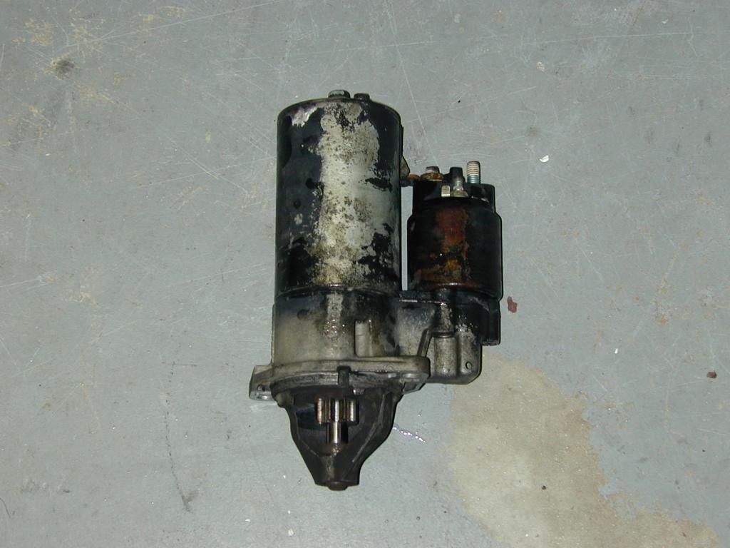

    Took about 2.5 hrs to get the starter lying on the ground. Thermostat housing looked shot, ordered a new one. Also some new intake gaskets and some BMW blue coolant for a refill. What a shitty job.

    thermostat housing

      starter hole.

        I feel ya, starter replacement is a PITA.

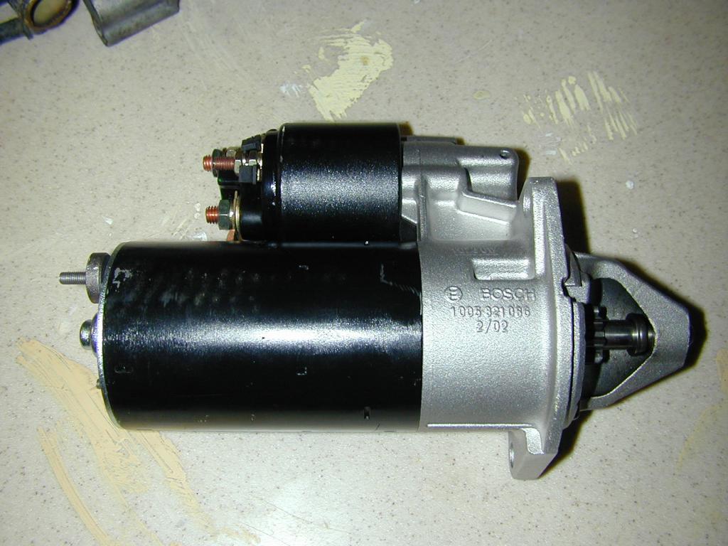

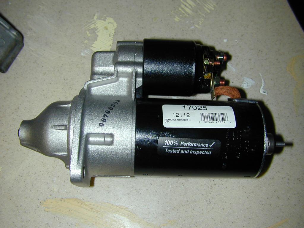

                      remanufactured bosch from autozone $119. Somebody please put my car back together.

                        pic2

                            PS: should I put a light coat of antisieze or grease on the starter gear or stick it in dry?
                            Should be a piece of cake to put back together. Just have to wait on the new thermostat housing. The old one was corroded and was leaking a bit.
                              Happy 4th of July.
                              just stick it in there, there is nothing to seize. I wouldnt grease it, its suppose to catch, you dont want it to slip.
