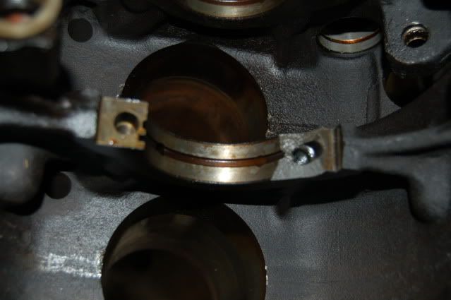

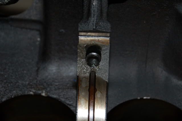

                          I'm figuring this is bad. Is this block useless, or can a machine shop add metal to this area and redrill/thread it and have it be good as new?

                            That block will make a nice planter, coffee table, door stop, etc. It's finished as an engine.
