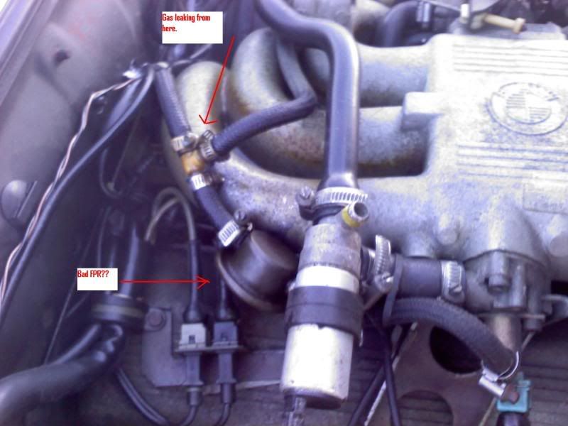

So it's idling (ever higher as it warms, because that's what it does, until about ~1500 RPM at which it starts surging up and down) and I'm cleaning off the snow, and I'm smelling gas. Bad. I shut it off and pop the hood. And this is what I see:
So at the yellow T-fitting in the picture there is dripping gas. The hoses running into the fitting are soaked in gas. And beneath the fitting on a hot intake manifold is a puddle of gas. Yikes.
I want to make it clear that I understand that when I unplugged the o2 sensor I made the ECU switch to a rich fuel map. But I don't think it's supposed to make fuel leak like this. The fuel stench on my coat makes it smell like someone fired up a weedwhacker in my room lol.
my best guess with out a Bentley:
Bad FPR, which is also causing my surging idle.
