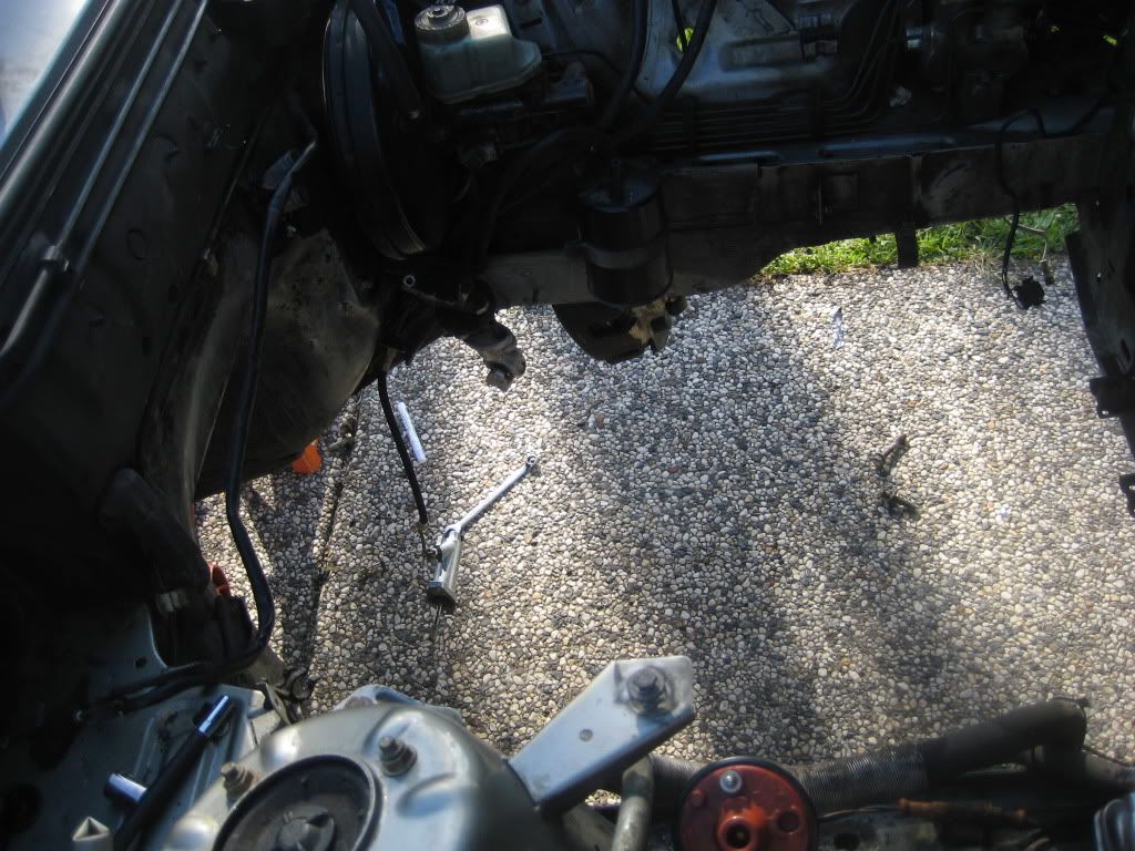

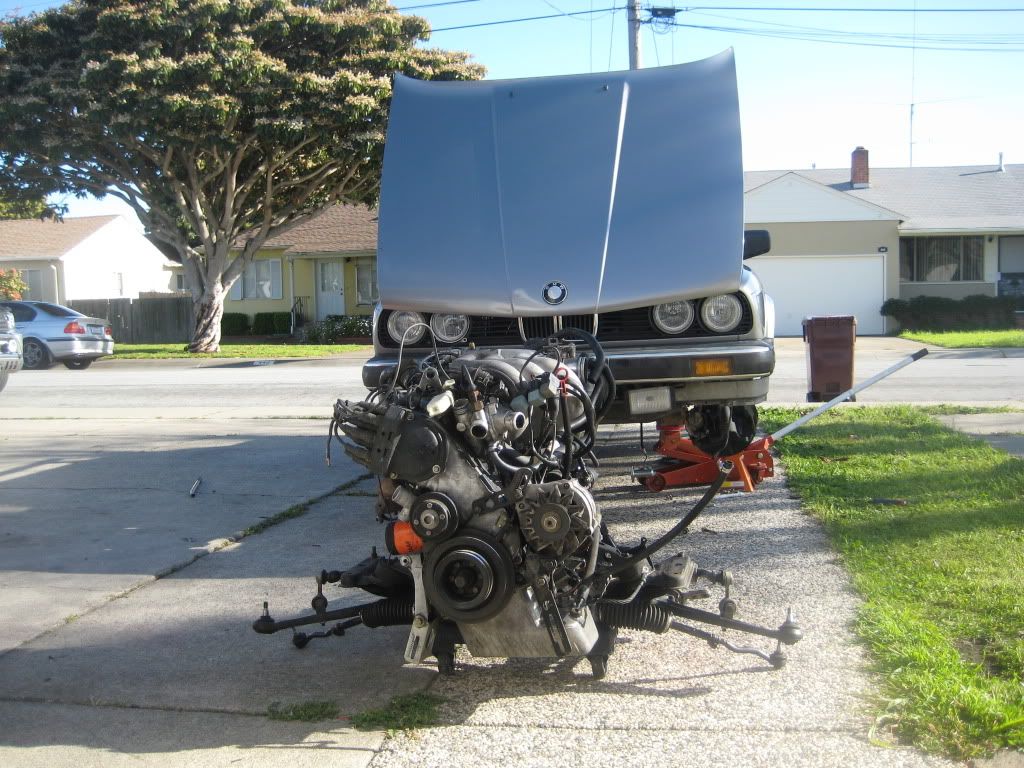

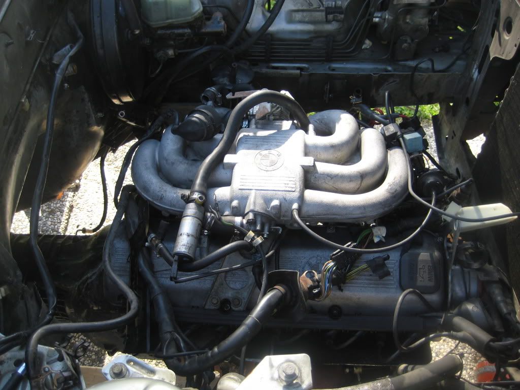

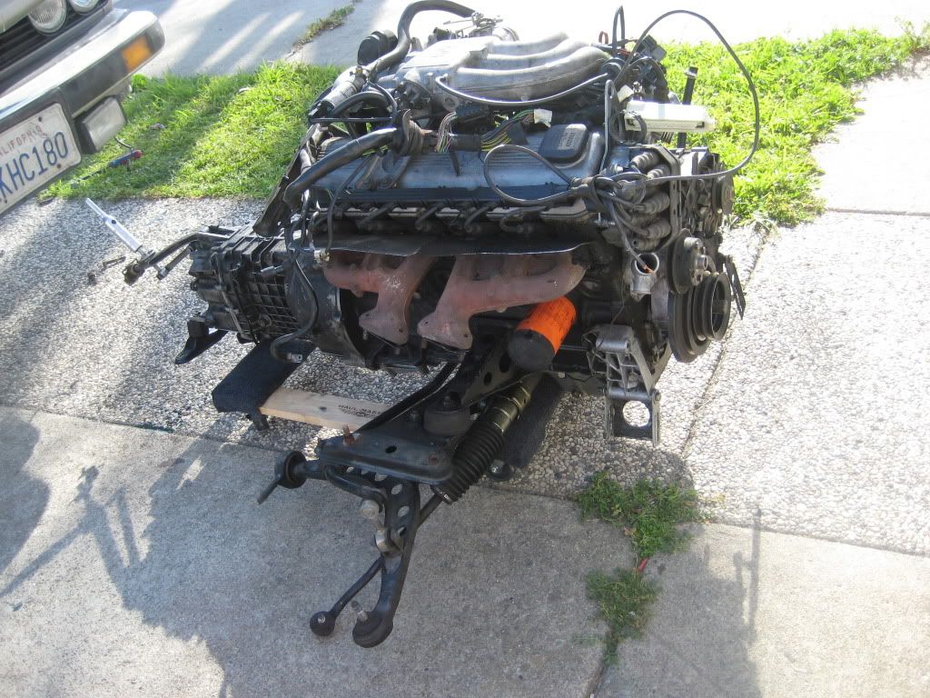

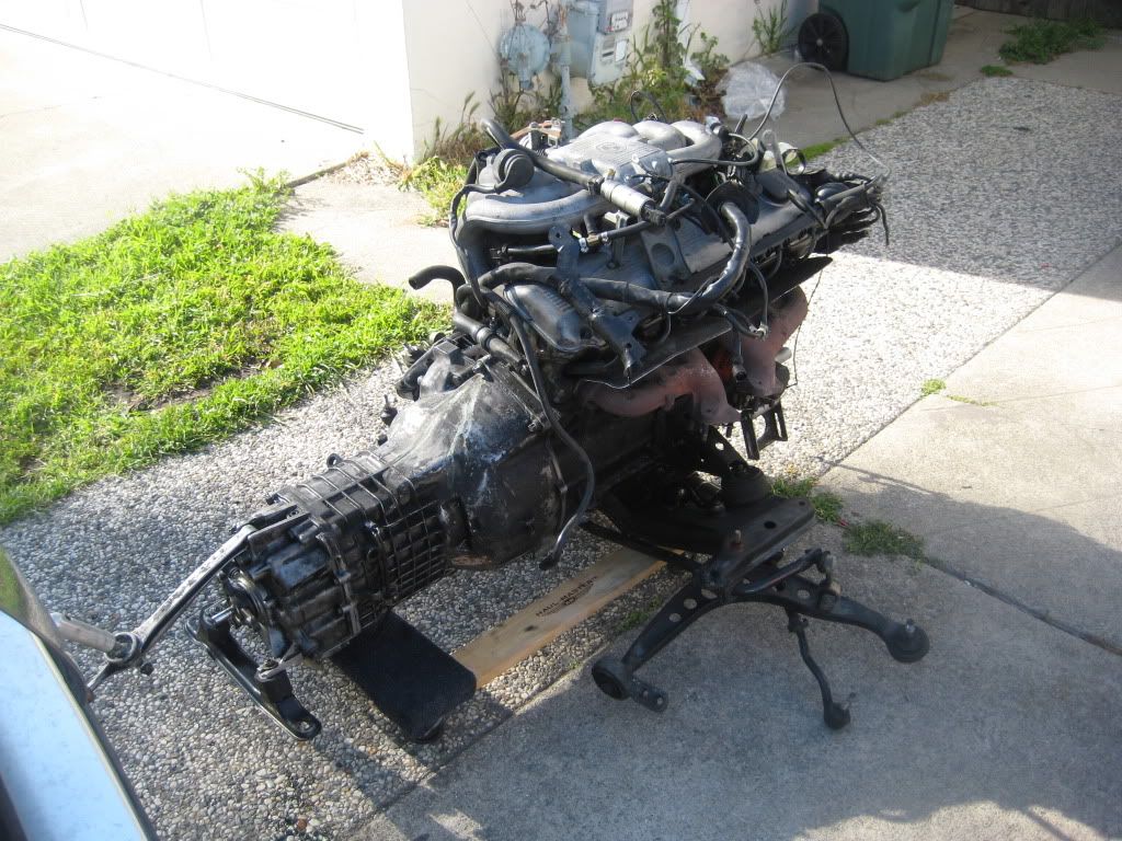

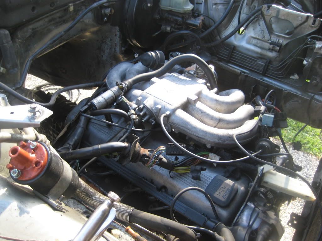

    Im doing the super eta with an 885 head swap and so far im here:
    Decided to drop it from the bottom rather than the top....
    That's the easiest way to do it!! I learned the hard way and ever since then, did the bottom up route.

        Pulling it from the bottom makes it look too easy. How long did it take?
          It took me total of like 3-4 hours...I worked on it last night for 2-3 hours unhooking everything. and an hour today to drop it. Be careful. I dropped it thinking one good jack will hold it and it didnt. dropped a good foot onto the dolly. Goodthing I wasnt in the way. and Good thing the dolly didnt snap. Its cake if you know what to unhook!

                            When the engine is dropped from below, do you just jack the car way up with a cherry picker or something to roll the engine out?
