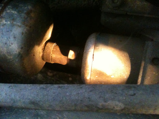

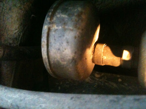

            These things right? I've been wondering what they are on my 86 e as well. Same thing as yours, filter is up front.

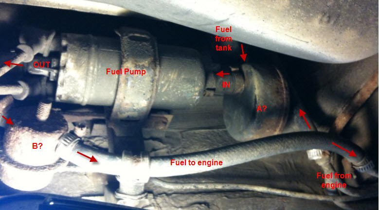

                  Here is a picture of my 86 external fuel pump area is attached. My question is what A and B are, called, part number? Some have indicated they can be ignored. Comments?
                  86 325e chumpracer, 87 325e RallyXer, 12 Boss 302LS, 97 Miata

                    http://www.realoem.com/bmw/showparts...72&hg=16&fg=15
                    • scrowner
                      • 49
                      Thanks. Good info. So the input metal can is no longer available. I have read a few other forums indicating that removal of A and B has not affected performance. I am replacing the fuel pump with a Walbro from trepreformance. I am also adding to the system a fuel accumulator I purchased from http://store.nexternal.com/shared/StoreFront/default.asp?CS=ireland&StoreType=BtoC&Count1=67530 4591&Count2=592445015&ProductID=471&Target=product s.asp:)

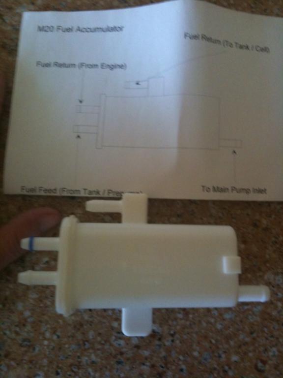

                              Here is a picture of the item I purchased as an E30 accumulator. However, it did not solve our problem with fuel starvation in this 1986 E30. We are currently in the process of switching the fuel tank to a '91 tank, changing the fuel delivery to a single in tank pump. A number of E30 guys have indicated that the older E30s, older than 1988, dual fuel pump systems, are a problem. Yep, both our pumps worked just fine and we get the fuel starvation after things warm up in the car. So, initial few laps have no starvation then we get starvation from that point on. We tried extending the intank pumps suck-in point with a fuel line deeper into the tank but had no luck. To recap our discoveries:
                              1986 E30, removed items A and B shown earlier in this thread, verified operational in tank pump, replaced main exterior fuel pump with Walbro, added fuel accumulator in the system in between tank delivery and tank return. STILL HAD FUEL STARVATION.
