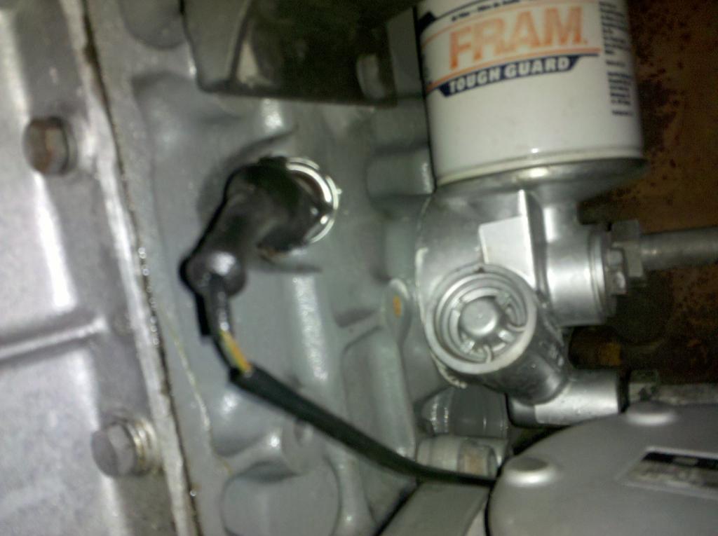

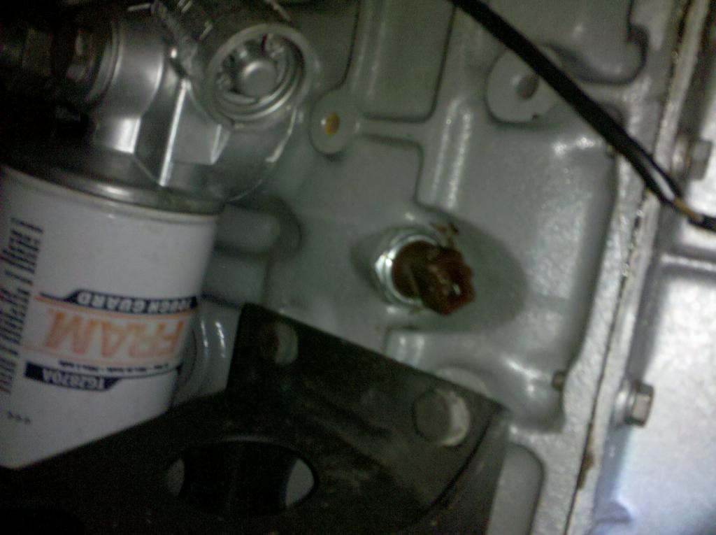

    just put a new oil pressure switch on my 89 325is, now it time for an oil change i live in south Florida and its my first time changing the oil on this car, should i go synthetic or regular what have you guys used on your cars what works best. any suggestions? hers the pics of oil pressure switch
