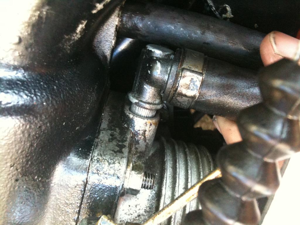

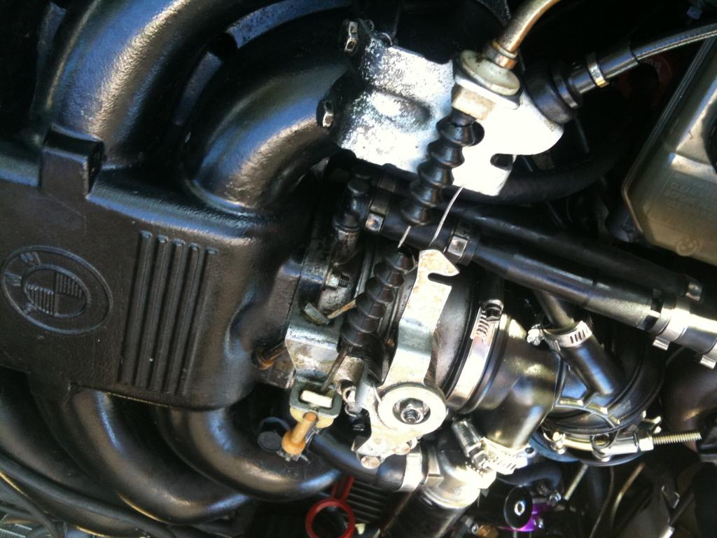

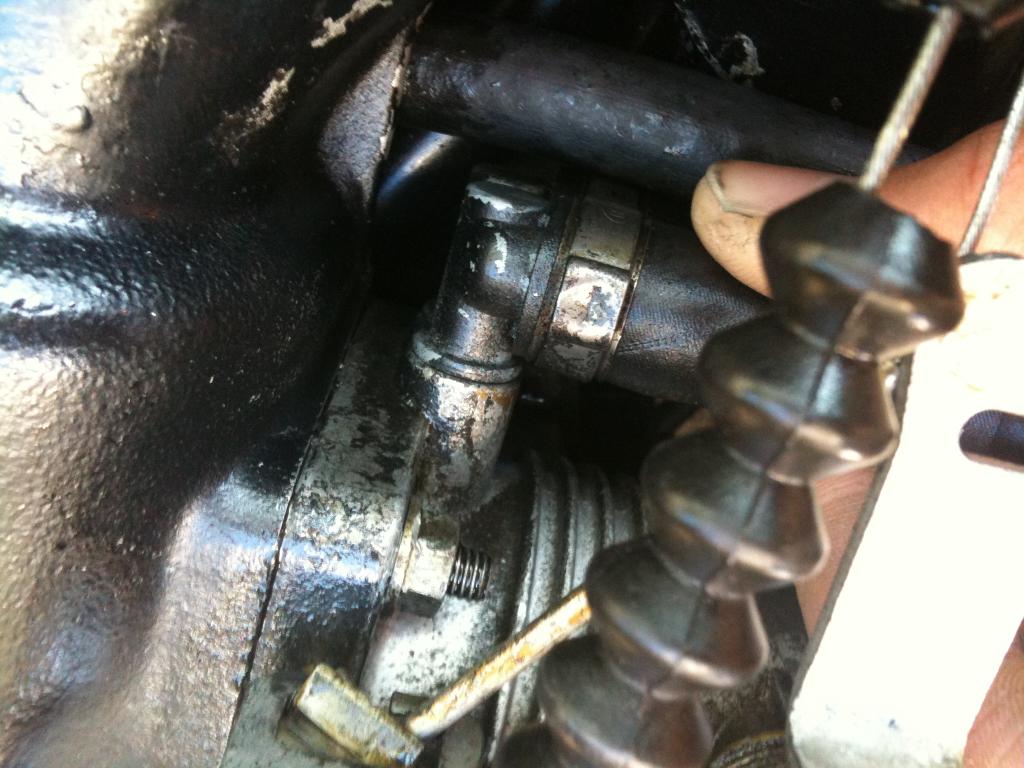

    can anyone tell me what this little push in fitting is called? its going into the intake manifold.its pretty loose in there and i have some crazy vacum leaks and i think this is causing a lot of it.
    mabey just put some red rtv around it, and push it in?
    any help would be greatly appreciated.
    thanks
  • jlevie
    • Nov 2006
    • 13530
    It is an elbow and is only available as part of the throttle body. Remove the elbows from the throttle body (both are probably loose). Clean the socket and the nipple with acetone or lacquer thinner to remove all oil. Glue them back in with JBweld and allow the JBweld to cure for at least 12 hours before driving the car.
