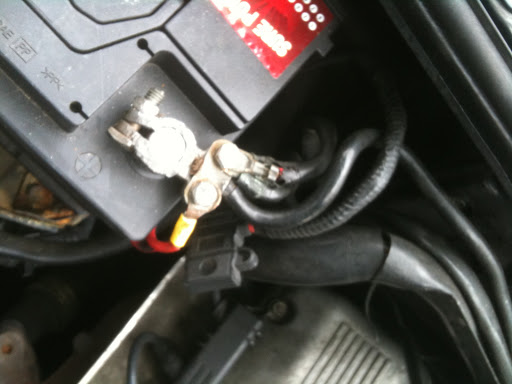

          I have four running from the pos terminal on my vert's battery (ok 5 when you include the amp cable). Here's a pic
          Not sure this will be much help, but two run to the fuse box, one runs to the starter and I'm assuming the other one runs to the DME, but I could be mistaken (sorta just disappears into a loom).
          I've converted my rear battery e to an i harness though. Because it's a track car, I had to wire in a kill switch and I used the front terminal you're talking about as my interrupt point for the switch. I can take some pictures of what the final setup on that looks like if you think it'll help. Not stock, but easy enough to figure out I think.

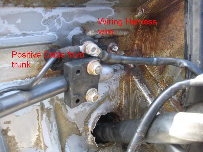

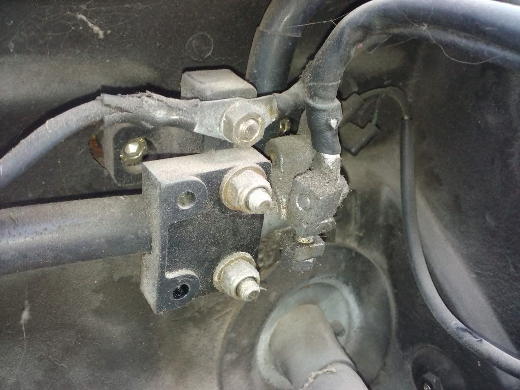

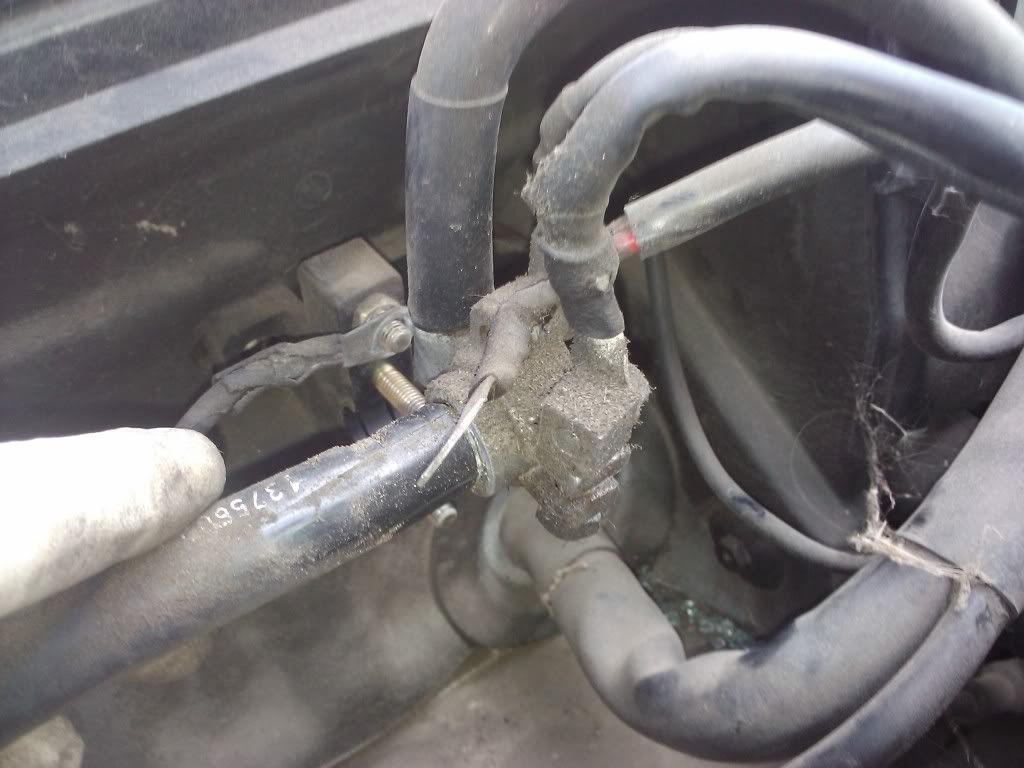

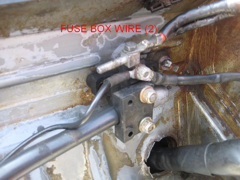

            Here are pictures labeled...I think I have all of it but from the pic I took at the junkyard it seems like Im short one thick cable...
            JUNKYARD CABLES
            My Current Set Up.

              Looks like the cable that runs to your starter is missing?
              Going out drinking tonight, so no pic of my motronic 1.3 converted e setup 'till tomorrow, but I'll snap some pics and do my best to explain how I have shit rigged. I'm not completely sure why, but I wound up having to use the starter cable from my e harness to make everything work right.
                Your right. I just realized that right now..its been awhile since I worked on it so I totally forgot the starter post has two cable coming out...thanks man! I appreciate your help!
