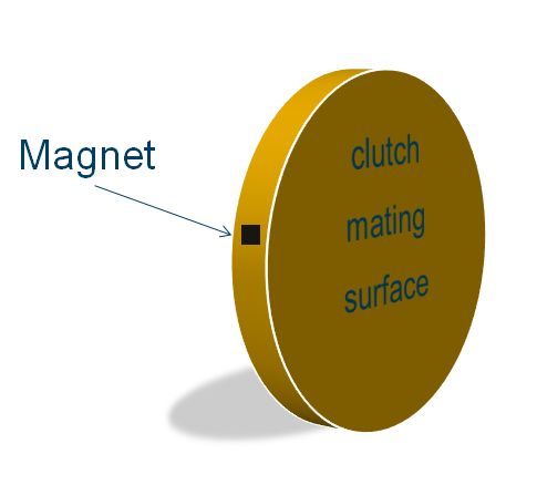

    Originally posted by accident View Post
    no, without the magnet the sensors have nothing to read and the car wont run
    I understand that and agree, my point is i do not see this magnet on the flywheel do you see it in the pics? am i looking in the wrong spot?
      #32
      It will be on the flat surface on the edge of the FW next to the starter ring gear thingy. It looks like a little square piece of metal welded on. It will pass real close to the sensors so it will be in line with those.
