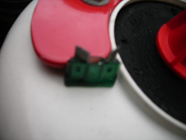

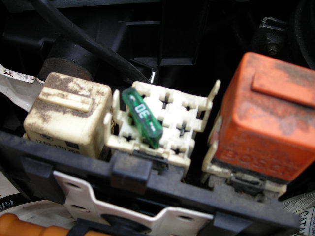

            In that case, give this trick a shot too with the fuel pump relay. Check power at 11 with this in place, and try to start the car.

              it's pushing gas while the motor is cranked.
