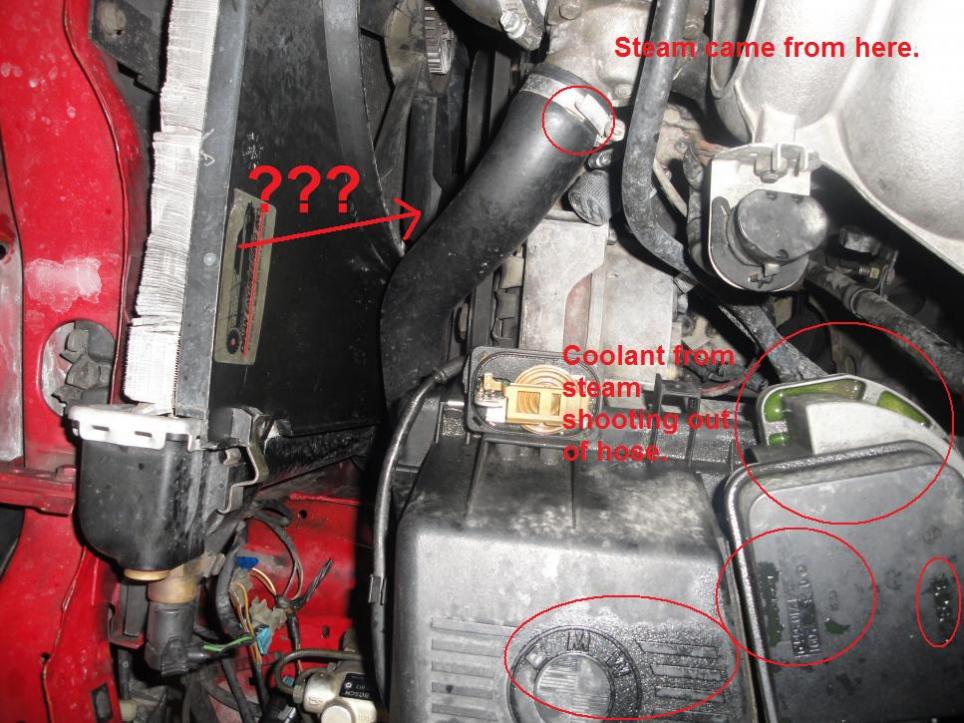

    Alright so I have an '87 325e and it overheated earlier today. I popped the hood to cool it down and steam was blowing out of a hose shown in the picture attached. I don't know which hose it is. Is it this one?

    a hole in the hose. Ive had a leak on the same spot
    Its time to buy a new one

        is the hose in the link the correct hose?
        '87 Zinno 325e
          Yes it is. When your going to change it have some more coolant read or water. remember to bleed the system ( cap off the res and let it run for a good 15 mins or more. ) if you need help feel free to PMME , im in the Los Angeles area.
