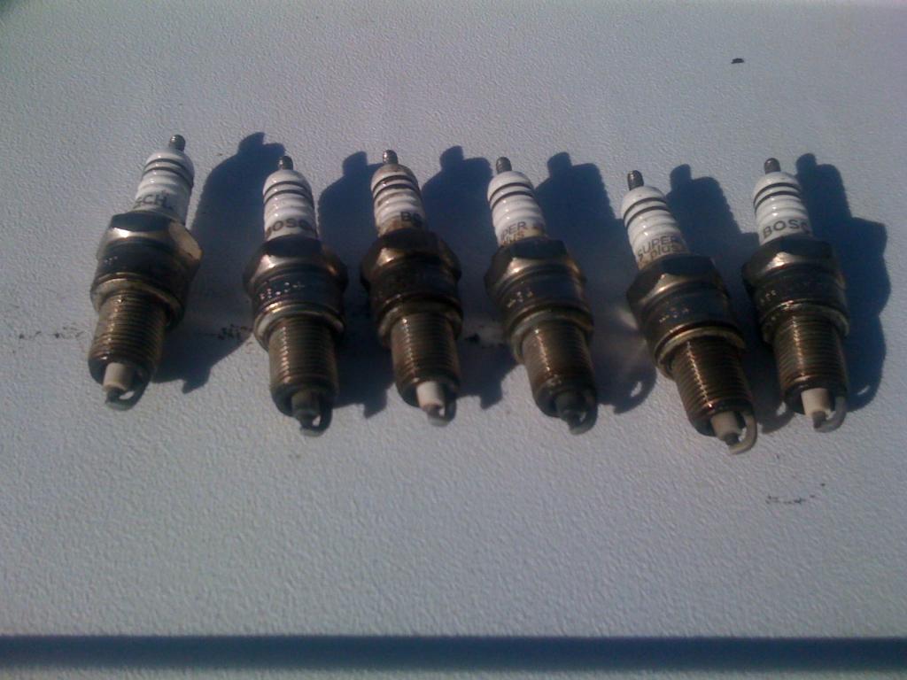

    Well there is something wrong with my car. When warmed up the car has rough idle. When driving and it reaches between 3-4k RPM. the car seems like it has a miss.

    I was thinking maybe i have bad injectors? no idea
    I took a pic of my spark plugs and plug 2 and 4 dont look good at all. these were brand new plugs about 2k ago. Any suggestion would help.

    try cleaning out your ICV(idle control Valve) just spray some brake kleen in there and it should be all set.
    had a similar problem.

      well looks ,like im loosing compression on cylinder 4 .. Time for a M50 swap!!!
