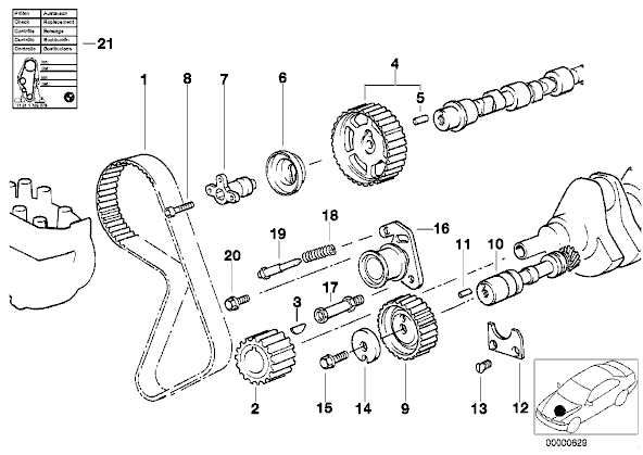

    so currently i have a four door bronzit (89) that has a rebuilt head less then a year old..rest of the car is quite tired
    an i just picked up a coupe of the same year in much better shape other then having a snapped timing belt..(this was after telling the last 2 owners to have it done...)
    plans are too take a weekend with some friends and swap the good head over to the coupe..
    now i am picking up the obvious parts ..ie:HG and head bolts..TB and tensioner and water pump..
    is there anything else i should consider replacing while doing this job?
    and hints or tricks i should know of?
    doing all the obvious foot work on here and a few other sites but figured i would also try aking about it..
    i feel it should be a pretty straight forward job but we all know how that goes lol

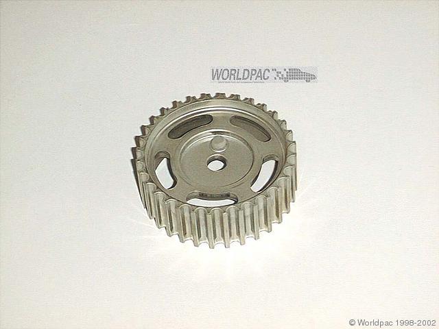

          if your intermediate shaft sprocket doesn't look like the first pic, it may end up looking like the next one. might want to replace it too. ruined my day...same results as a broken tb. don't know why the pics didn't show properly...i am not well schooled on adding pics to a post, sorry. anyone feels sorry for me...give me the heads up on full pics...lol
