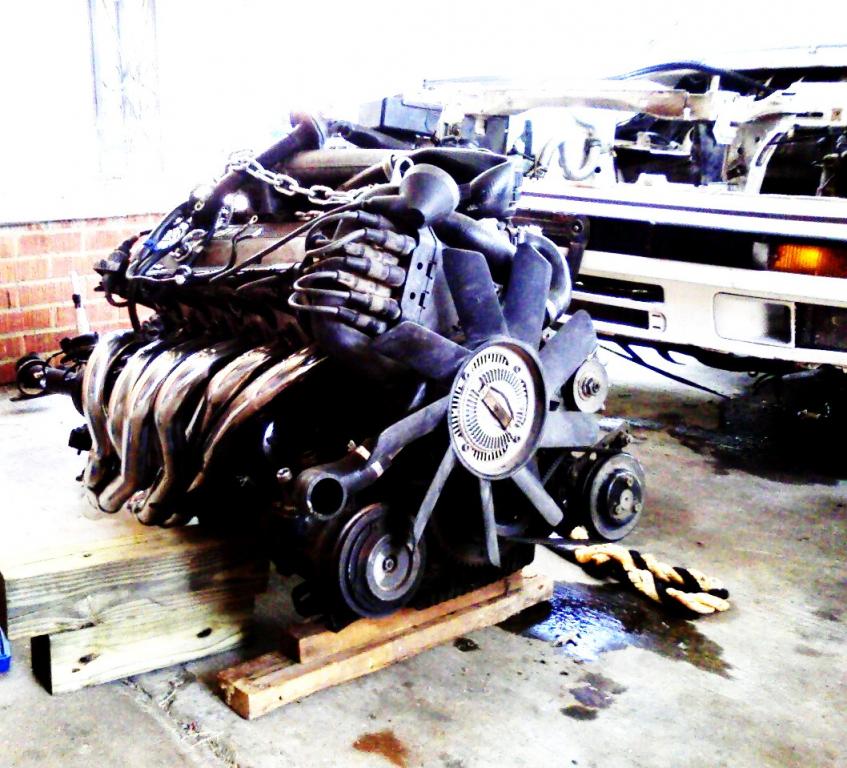

1989 325i engine going into 86 325e
  • brickvolador
    • 55

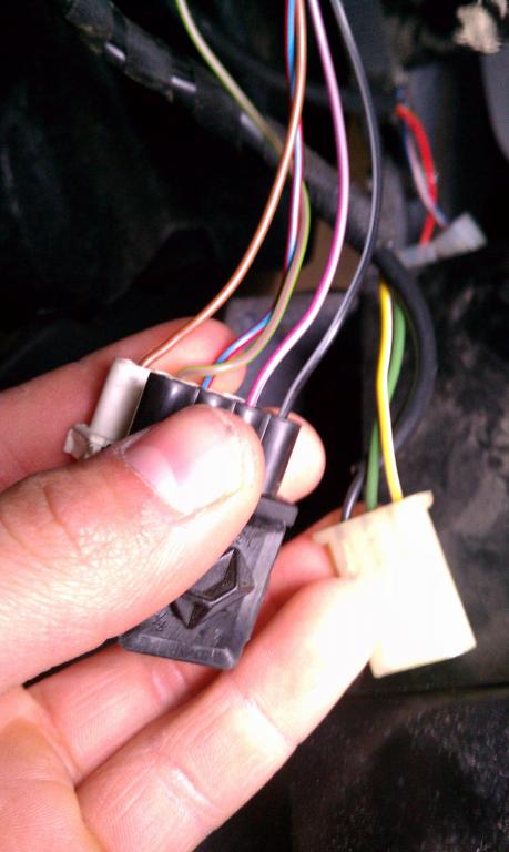

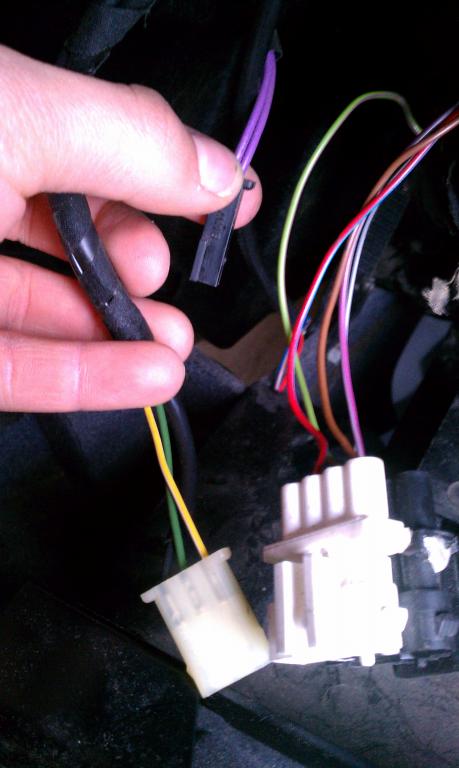

    ok guys i finally did my engine swap! the car is running perfect.. well almost lol i need help to make the rpm tach work, the 3 cables in the glovebox. help please!

          Dude, down load the wiring schematics for the 2 years involved and look for the tach wire (one wire) that has to be spliced into the C101 I believe. That is pretty much it. Run that wire and you should be good to go. Best way I found was to print that crap out and grab a highlighter....and a beer.

              LoL THANKS man !! im totally agree about the beer! umm so i just run the rpm tach cable to the c101 connector, do you know what number?? :) i honestly cant read those wiring schematics man!!! too much for my brain i just see lines and more lines! LOL

                  It is one of those 3 wires Black, yellow, or green.
                  I'll check when I get home after work. I still have all that stuff in a folder.
                  One of them is the tach and one is the fuel economy gauge which I never ended up hooking up.

                    The easiest solution to this is to scavenge the C104 connector from the old harness and graft it into the later harness. The wiring diagrams available at http://wedophones.com/BMWManualsLead.htm will be helpful.
