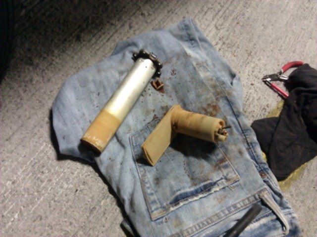

    I just switched out my in tank transfer pump with a TRE340 yesterday. My OEM transfer pump was so jacked.. the strip of metal that connects the ground terminal to the return line on the pump assembly to ground it out was broken clear in half just because it was so old. I bet it was the original!

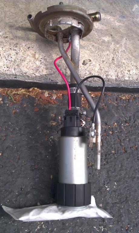

    Anyways, having a 255LPH pump in my tank, do I really need that external pump in there as well? And for that matter, if my TRE340 already has a filter on it, do I really need that external in line filter too?
    Seems like extra failure points to me, but if they aren't going to bother anything and I should keep them operational, so be it. I replaced the in tank transfer pump because I thought that was the one that was whining. It was actually my external pump that was whining and it is giving me fuel cut off problems after it runs for a while.
    Today I installed the TRE340, a new fuel level sensor, some new lines here and there, and the external fuel filter. Now I have to change the external fuel pump and I am just wondering if it is worth the expense.

    You no longer need the external pump, but you do need the filter still. The thing on the TRE pump is more of a strainer to prevent pump damage. The filter is finer to prevent damage to the rest of the fuel system.
    Also, You will have electrical problems soon with your setup.
    Grounding to the fuel sender chassis is inadequate due to the O-ring seal, which will cause issues with the TRE pump trying to find a ground through your instrument cluster. Adding a ground strap from a sender nut to a clean chassis ground will fix that though.
    The other part is the connector to the fuel pump. BMW revised that connector on the late model cars with larger terminals and heavier gauge wire to the connector to support a high pressure pump. In your case, to prevent leaks I would use the original connector, but connect both terminals to the power wire of your fuel pump, since you have a separate ground now. Connect a heavier gauge wire between both terminals of the plug and run it down to where the external pump was, and connect to its power lead (which you will see was a heavier gauge). If you do that, you should have a setup as reliable as a late model E30 originally equipped with the single pump.
    -Dave

      Since you've replaced the low pressure transfer pump with a high pressure pump, you can eliminate the high pressure pump. But you do need to retain the fuel filter.
      The cut outs may be from a dying high pressure pump, but they also might be from rust in the tank. Rust in the tank can collect on the in-tank filter screen and starve the pump for fuel. If there is a good bit of rust in the tank you need to replace the tank or acid clean and seal the tank.

        Dave, are you sure that the in tank assembly grounds through my gauges? That grounding point that I attached the ring terminal to was the same exact point that the OEM transfer pump was grounded to before I removed it. At the top of the assembly, when you are looking at the fuel line hookups and have the fuel level sender unit removed, there is a connector for the transfer pump plug. If you inspect it closely you can see that the negative terminal on that connector is permanently attached to the complete assembly while the positive terminal goes through the top and is insulated by a piece of plastic until it gets to the point where I soldered the red wire on the inside.
        Remember, this is not a late model E30. My in tank assembly looks a lot different than any late model car. It even looks different than an ETA assembly.
        The fuel sending unit has it's own positive and negative terminals and I do not see it grounding through in tank assembly.

          PS - the reason I don't believe it is grounding through my gauges is because the in tank pump will cease to work if I pull fuse number 11 (fuel pump). I was sitting there with a voltmeter the other day checking that out before I plugged everything back in.

            The fuel pump ground and gauge grounds are under the rear seat on the left side of the car.

                It doesn't normally ground through the gauges, but the connector the power and ground currently go through will heat up and become an issue with time.
                I'm suggesting grounding to the chassis and running power through both sides of the connector.

                  Gotcha. Yeah, guess I will ground it to the chassis back there somewhere with a ring terminal around one of the sender unit screws.

                    The pump is already grounded to the chassis (see above). You need not do anything with the wiring.
