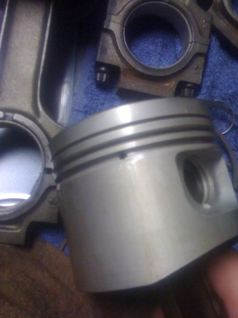

            I figured this belongs in this thread rather than making a new one.
            Can someone help me out here? ( Newb and rebuilding an engine.)
            This is my piston from my 1987 325i
            And long story short I had to order another piston from Pelican Parts (http://www.pelicanparts.com/cgi-bin/...9%2C%20Each%20)
            but it looks different, it has skirts. All the cuts are the same on the top but the skirt is different
