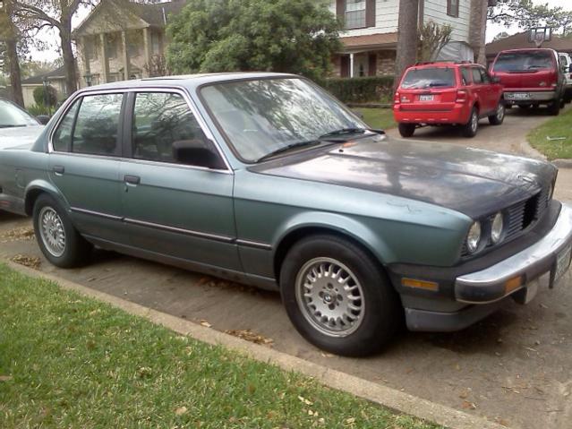

    sup guys, new here so on and so forth. ok to the problem, i recently did a tune up and now my 87 325i is acting up, starts up fine and idles fine (a little low about 500-700rpm ish but smooth) but when i blip the gas it hesitates and if i blip it enough times it stalls out. i tried covering the air filter box and the engine keeps running which is a sign of a leak right? except when i take my hand off the hole it stumbles and dies also when i start the car up, the MPG gauge under the tach. goes from 40mpg to about 20 then shoots up to 40 again then goes down to 0. is that a sign of anything? ill try to post a vid or some pics soon,thanks again and great forum. ohh here she is btw.
